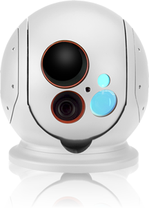

IRCCTV   0 Posted November 28, 2009 Hey  Check out Ascendent Terr IR PTZ'   The Terra PTZ delivers super long range day/night surveillance. Its powerful 20-2000mm motorized zoom lens can detect intruders at distances up to 20km by day and detect vessels up to 30km away. It's twin, high-powered, continuous-wave laser active IR delivers intruder detection at 8km, recognition at 3km and identification at 1.2 km in complete darkness. The Terra Series delivers unparalleled surveillance, situation assessment, and perimeter protection for military installations, borderlines, airports and critical infrastructure worldwide.   Google Terra IR to find it  its manufactured by Ascendent Technology Group Share this post Link to post Share on other sites

IRCCTV   0 Posted November 30, 2009 You don't buy a camera like that from Korea   for warranty and support purposes.   its a about a $130,000~$180,000 camera.   But they do seem to make some great IP components. Share this post Link to post Share on other sites

IRCCTV   0 Posted November 30, 2009 Well here is Ascenents press release for the Terra:   http://www.prlog.org/10354774-ascendent-terra-ptz-18km-extreme-long-range-active-ir-surveillance-camera-2000mm-zoom-lens.html  They also will customize it I had an application where I need IR and 30km thermal and they designed me a system using there active IR and Cantronics thermal.   They also sell the laser if there is enough MOQ and will customize the laser for specific requirements. Share this post Link to post Share on other sites
rory   0 Posted November 30, 2009 Sounds alot like marketing hype, everyone does that these days. Another thing, why dont they show videos or even images of their product in action? Makes no sense ...  What EM-CCD camera is it? Who makes the IR (they look chinese)? Lots of questions you may not get an answer to. BTW a samsung EMCCD camera runs around $5000, even with the best IR out there, a PTZ controller and the zoom lens, i dont see how it can reach $100,000. But hey ... if someone has the money to waste then go ahead.  by the way for anyone interested, here is the link to the "manufacturer" web site: http://dealer.ascendentgroup.com//dvr-ir-cameras/10km-ir-ptz-laser.html Share this post Link to post Share on other sites
IRCCTV   0 Posted November 30, 2009 Its not Hype have you been to there website they have no marketing at all just good products. Bosch and pelco those products are all about marketing as they spend more money on marketing and selling then they on product development.   They use dual laser where someone like Vumii uses one. And addition 2 fllod light to capture the fist 500m as with most laser system don't illuminate a lot the first 300m.  If you buy the Lens direct from Raymax it is $65,0000 USD for the 20-2000mm lens. Where as the 1500mm lens from fujifilm is around $7,000.  http://www.ascendentgroup.com/pdfs/Terra%20PTZ%20overview.pdf  Its not Hype its the longest Active IR camera using continuous laser (observe pulses the IR)   Its not a cheap camera but is extremely high end and not based on hype based on performance.  Press release: http://www.prlog.org/10354774-ascendent-terra-ptz-18km-extreme-long-range-active-ir-surveillance-camera-2000mm-zoom-lens.html  PDF from Ascendent the link u posted is a short description for shopping cart.  The PDF can be found here: http://www.ascendentgroup.com/pdfs/Terra%20PTZ%20overview.pdf Share this post Link to post Share on other sites
