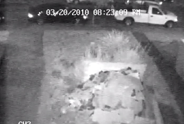

How does this look?
With street lights
Built in IR only between houses
Built in IR only in a garage

It looks better on the screen connected to the DVR, but it still isnt as good as yours.

With street light and drive way lights
With no lights. Only a street light a couple hundred feet away.
