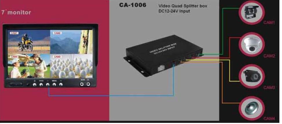

If you want to simplify a bit, you could use a quad or multiplexor to generate a 2x2 split-screen display (four images), then use an active video splitter to send that feed to your two rooms and the control room, so everyone sees the same thing.

It's a really poor picture, but this gives an idea of what I'm talking about:

I'll have to educate myself a bit re: that multiplexor gizmo... I'm guessing there's some arrangement that allows all the cameras to use one common sync signal, but maybe it's actually buffering frames prior to display.
Sync isn't really an issue with the split-screen; the only place sync issues tend to be noticeable is when doing a sequence (switching from camera to camera full-screen), where it can cause a flicker or a jump in the picture when switching.

As for researching multiplexers, here are a few examples (not necessarily suggestions or recommendations): http://shop.ebay.com/?_from=R40&_trksid=p3907.m38.l1313&_nkw=4ch+multiplexer&_sacat=See-All-Categories
Models like the Pelco and Robot are very common professional CCTV units - before DVRs became a more cost-effective option, these were used extensively for recording multiple cameras to a single time-lapse VCR (other brands that we've used a lot of are National Electronics and Sanyo). If you decide to go the split-screen route, any of these are a good choice - you don't need to worry about camera sync or anything like that
