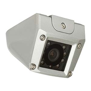

Guest Posted July 12, 2010 i see, thanks for the input, really helped me alot:) Try the Conway CM180, made for the job. www.conway-cctv.com Ilkie Share this post Link to post Share on other sites
Soundy 0 Posted July 13, 2010 Speco has a nice hi-res camera for that application. it is part number CVC-607EXCM/2.5 , and can be seen herehttp://www.specotech.com/cart/products/productDetails.asp?prodID=704 I hope their cameras are better than their ad copy... "This is a perfect 90 degree corner mount color camera which includes tamper resistant screws. The camera features 420 line resolution, 1/4"" CCD format and 2.9mm lens. It has a built-in electronic shutter behind a 16 gauge steel face plate. Also available with 480 line resolution and ExView 2.5mm lens: CVC-607EXCM/2.5" In our case, we just repurposed a used Extreme dome... I don't see the point of the IR in the Conway offering; any elevator should already be well-lit to comply with safety codes. Share this post Link to post Share on other sites
Guest Posted July 13, 2010 Speco has a nice hi-res camera for that application. it is part number CVC-607EXCM/2.5 , and can be seen herehttp://www.specotech.com/cart/products/productDetails.asp?prodID=704 I hope their cameras are better than their ad copy... "This is a perfect 90 degree corner mount color camera which includes tamper resistant screws. The camera features 420 line resolution, 1/4"" CCD format and 2.9mm lens. It has a built-in electronic shutter behind a 16 gauge steel face plate. Also available with 480 line resolution and ExView 2.5mm lens: CVC-607EXCM/2.5" In our case, we just repurposed a used Extreme dome... I don't see the point of the IR in the Conway offering; any elevator should already be well-lit to comply with safety codes. Its the difernece of what happens according to code and the reality of the situation. We support many elevator systems in public housing and it is very rare for the lighting in the lift car to to specification. Dirt, burnt acrylic, one tube blown are all very regular features of elevators in public housing schemes. IR can be of use in these circumstances. Ilkie Share this post Link to post Share on other sites
