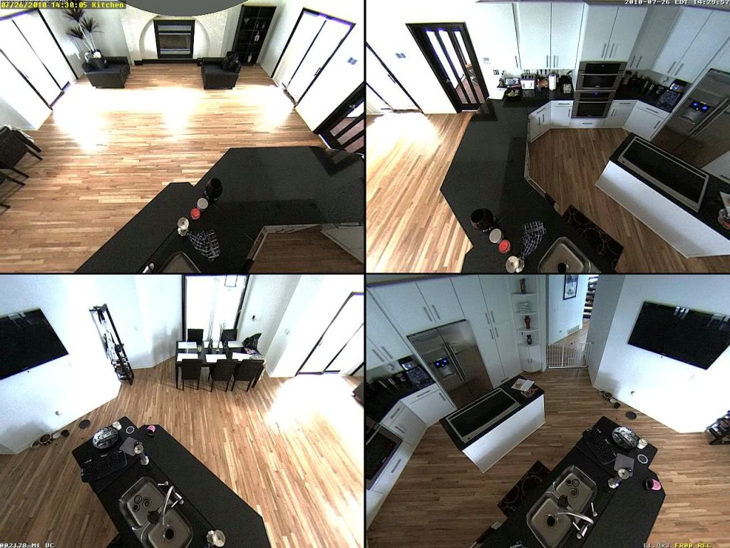

First off im new here. I purchased 2 mobotix q24s and sent one back and purchased 3 vivoteks. I really think the mobotix image is crap. Ill ive tryed every setting i can do on the cam. Exposure brightness etc etc. The camera is focused but i think they are nowhere near the vivotek for image quality. I guess your just paying for the hemisphere images it can produce.

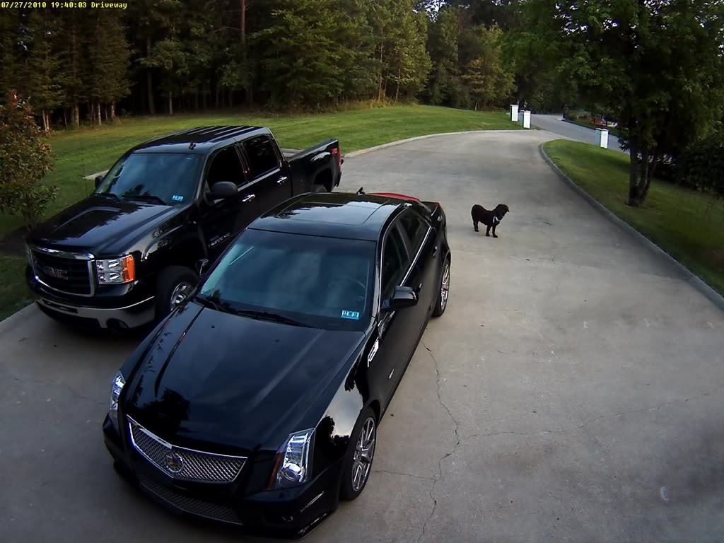

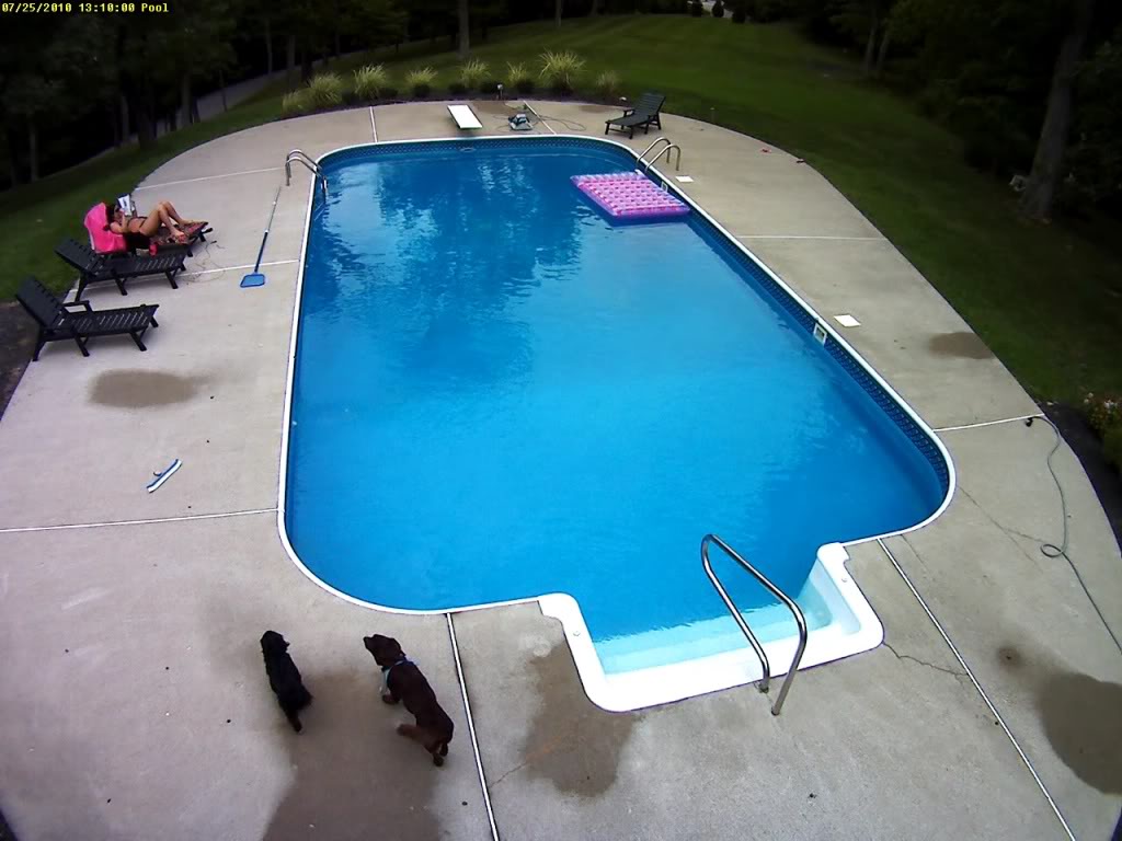

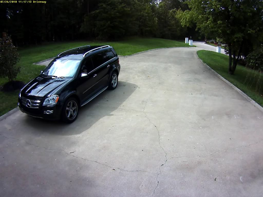

Vivoteks
Pool camera havent focused yet.
Mobotix q24

The Q24 is a great camera if used in the correct situation just like any other camera. The Q24 is for wide coverage with no blind spots, not detail images of peoples faces 30 ft away. If you where going to use the Q24 in the location where the Vivoteks are installed and you wanted detail it would never work. The Q24 is a tool just every other camera, use the correct tool for the job! At those outside locations if you tried a M12 you say the Vivotek image is crap. What are you using for recording?

You know i actually did put that mobotix where the vivotek sets now, and i took it down. I think a good example would be wall mounted anywhere but not so much ceiling mounted. The main problem i have, is with a good picture, i get horrible motion blur. Without the motion blur i get bad picture. Who knows. Im about to post some night photos.
the interior are some nice shots, especially for just a single camera.
though ofcourse can do similar with a 4 cam dome ... but the q24 quality looks good otherwise.

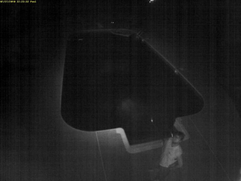

This Pool Camera hasnt been focused or anythin. Just installed. It was about to start raining and these are a pain to focus. No lighting on.

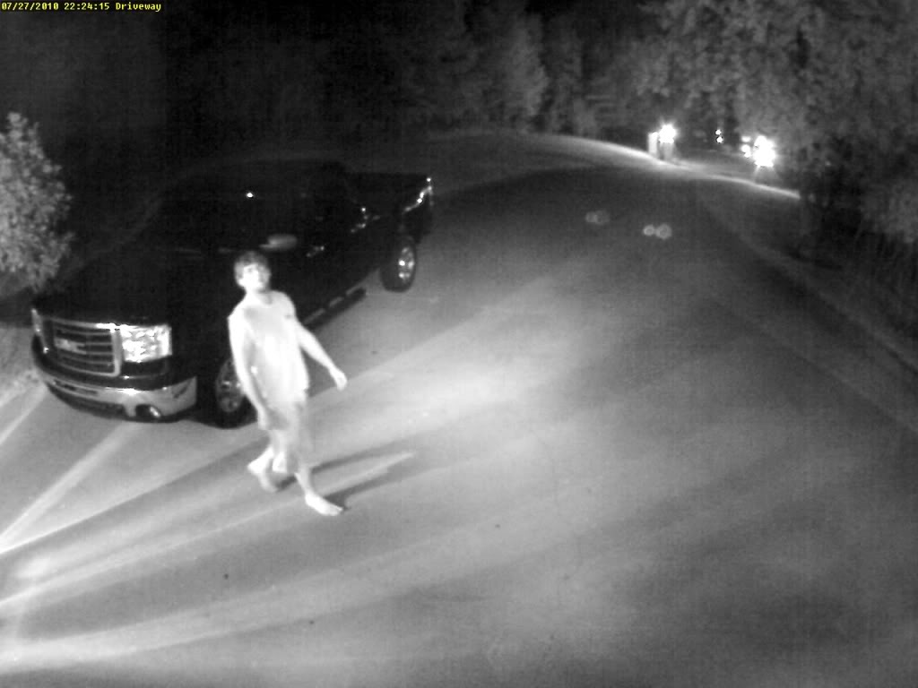

This on has to lights on both sides of garage. Probably needs some camera settings adjustments.

the pool cam looks about right for an IR dome .. they dont put out much IR in large open areas like that. Ive put what are normally decent IR bullets up at a pool and it was similar to that, a little more IR though .. but the only thing that really worked for me was the EX82 (not IP) but that kind of IR is not that cheap. Ive used more expensive IR bullets that claim the same or more IR as the EX82 and its not even 1/5 the visibility in the real world app. Maybe try a couple cheap 100' IR LED illuminators, they are inexpensive and although wont flood the area will at least give it some more visibility. You want to try get the IR to hit something, in your case there really is nothing, so try for the pool patio at the farthest end, hard to do without seperate IR or lowering the camera physically.
And i would sell the car and keep the truck for the roads down here
It looks like the ir directed in the pool or center of camera i guess. I have the lights off right now trying to figure out some wiring for my upb switch. The driveway im guessing could use some adjustments a little to whitefaced.
id lower the pool cam down to around 8' and it should be alot better. Either way it seems very high.
Thats what I had to do even with the EX82s. Lower the better and give it something within IR range to reflect off of.
Or install separate IR.

Thats pretty good. I guess my problem over there at my pool is that the soffit is about 14ft high and i have a brick house. I would have to drill and fish wires down the wall. I can probably just live with where it is.
