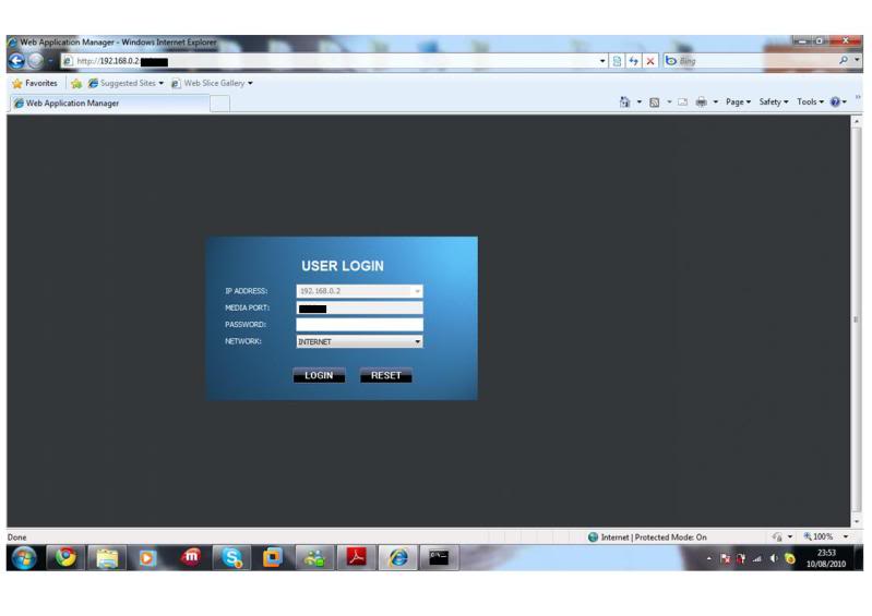

Dear all,
I've been reading and enjoying this site for a very short time - I'm relatively new to CCTV and am experimenting with my first system. I'm really hoping that one of you guys can help me out.
Firstly, I'm very sorry if my searching of the site has missed an obvious answer to my problem.
I have bought and am testing a KGUARD KG-SHA104 system. It works great, but I'm stuck when trying to access it over the internet.
To get as much info to you as possible, I am connected to the internet via a cable modem to which my router, a D-Link DIR-615, is attached. I have reserved the IP address 192.168.0.2 for the DVR and that is working fine. I have put into place the correct port forwarding details - having changed the media and web ports from their default values to new 'clear' ports (the DIR-615 will only admin on port 80, so I had to change - 2406 and 1012 respectively).
Furthermore, I have created and successfully configured my DynDNS account to match a free domain with my IP address. (http://xxxxx.yyyyyyyyyyy.org)
The problem is as follows:
I can connect, using IE7/IE8, to the DVR locally at http://192.168.0.2:1012. I am presented with the normal, as expected login screen - from here, when I click 'login' with no password, I can view the cams and enjoy the software.
If, however, I connect using my DynDNS (http://xxxxx.yyyyyyyyyyy.org) or even the WAN IP address of my internet connection then I see the following screen. It almost looks like the same screen, but from here I cannot proceed any further.
Note that the IP address field is now empty and the media port is now '0'. When I click Login, I get a small caption that simply says 'Login failed'. Maybe also worth pointing out that if you look at the icon in the tab heading of the page, this page still appears to be loading - I can wait 20 minutes and it will still show the circular moving 'loading' sprite.
Simply put, I can log into the system through my local LAN using the local 192.xxx network addresses, but if I try from outside the system, I seem to access the server, but there's some problem with the authentication process (I think?).
Any help would be greatly appreciated.

Check to make sure all of your ports are open. Go to your hosted LAN network and visit WWW.CANYOUSEEME.ORG It should pull up your WAN IP address and type in all of your ports that you use for your DVR and see if they are open.
Are you sure you are using the correct WAN IP address at the time you are logging in from the remote location? I have a Dynamic IP and whenever I type in an "Old" IP, it still gives me the login screen but it wont let me login. I then notice that my IP has changed to a different IP, so whenever I type in the right IP, it lets me login.
Of course if you have your dyndns configured correctly this should not be an issue.
As SEANHAWG said and...
Might be that something is not loading right in Internet Explorer. Your IE says that its in an unknown zone. IE usually says "Unknown Zone" when it is between one page and the next, before it has decided what zone the new page belongs in. Something is restricting IE from determining what zone to use.
Maybe active x is blocked. You may have to allow active x to run on Internet Explorer if the dvr uses it. Go to tools-internet options-security and set all zones to low if needed. Reset all levels to default or the original settings once done. Though you have a login screen, so I think active x is enabled.
See if your firewall is blocking access, either from your router or pc. Put your dvr address in the DMZ zone in your router to disable firewall to the dvr.
Ahh yes. I forgot to mention firewalls. I would temporarily disable all firewalls on both networks until you get it working. Once you get it working, then go in and configure what can pass through your firewalls.

i have exactly the same problem at login!
but, i havent changed the media port. it's the default.
so i configured dyndns etc etc. but at login from IE the password is not accepted. (login failed)
note that i have changed dhe admin and user password from the dvr menu, but even with them i still cannot access from IE. (from internet)
To make it more strange, i can access locally with the default software from any pc of my network but it only accepts the password 123456 not mines!
and even with the password disabled from the menu i still cannot access from internet.
and localy again, with the password 123456 and only as a user.
i dont think it's the firewall. maybe media port? or maybe i have mixed and troubled the passwords? how can i reset the dvr ?
y'all need to go to your local network where your DVR is at and get on a computer there and visit the website:
www.canyouseemee.org
It will automatically show your wan IP. You then need to type in all of your ports being used for your DVR to see if they are open.
Another great tool is:
http://www.grc.com/default.htm
Scroll down to visit "shields Up"
Follow through to the page where you can click "All Service Ports"
This will show the status of all the ports from 1-1056
Finally i resolved it. it was the firewall of the router. i created another roule under the options of firewall to enable access of the local ip (dvr) that i wanted to communicate with over the internet.
Thanx 4the attention!

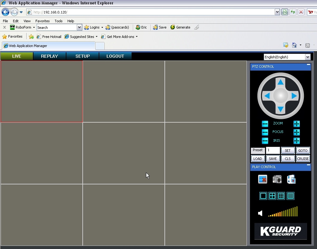

Are you able to see video (cams) when logged in locally to your network? Or are you getting greys no matter where you login?
If you are able to logg in but are seeing a gray picture instead of cams, It could be a graphics cards driver. I had this issue awhile ago.
Be sure to change to "prompt" the "download unsigned ActiveX controls. in the browser under internet options.
Also be sure your DVR info matches your routers info. This includes media port-port forwarding.

No everthing works fine on the local lan - Just grayed out when i log in from my dyndns account. I will check the active x prompts. When I first logged in it said it needed to run them I let it run the active x but just gray camera boxes
Ok my system did come up now through the dyndns account. But I had to revert back to IE explorer 8. Version 9 I believe has to many bugs. Worked on it for days - All my settings were correct. As soon as I uninstalled 9 and revertted back to 8 the system came right up.

I am having the no video problem with the web application.
I have several computers, web access works fine with 3, but fails to display anything on 1:
I am accessing over the local LAN, so no port forwarding issues.
The web control activeX control installed fine, and all functions work but there is no video. Even on the Replay tab the saved videos appear to play but display nothing.
My 3 other pc's which do work fine have identical software, but different hardware.
I think it has something to do with the Intel integrated graphics. The 3 other pc's all have video cards by ati, but this one uses the onboard Intel graphics. I also tried to load the web app from my work pc, which uses Intel graphics, and experienced the same problem.
I tried updating the video drivers but it had no effect.
Finally got it working. I bought a cheap Zotac videocard and put it in, and it still wasn't working. At that point gave up and disconnected the monitor. Then started on with it again working with the pc remotely over UltraVNC. After days of fiddling with every video setting possible, updated the video drivers, and then I tried disabling the 'mirror driver' in ultravnc. Rebooted and it was working. So I'm not sure if it was the video card, updating the drivers, VNC the whole time, or some combination. So if the Kguard activex dvrocx.ocx web dvr control seems to be working but shows gray boxes where video should be try disabling the mirror driver in ultravnc.
