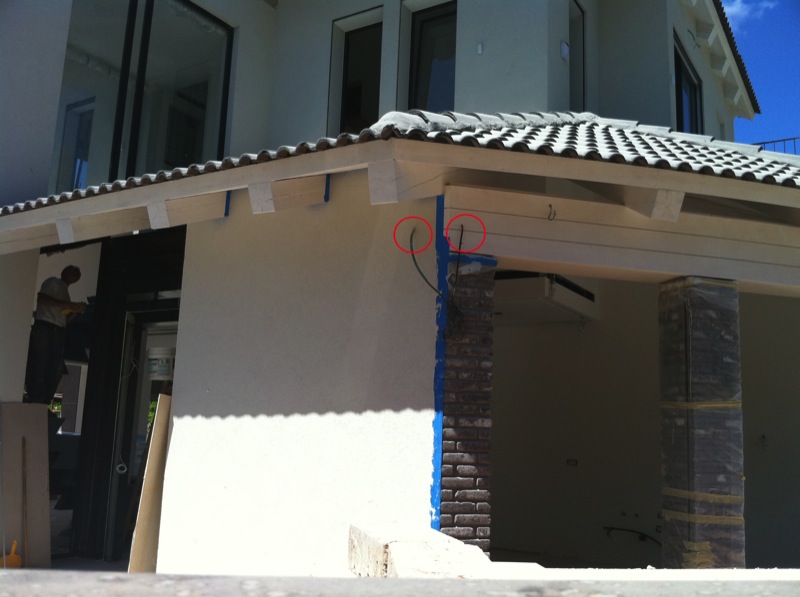

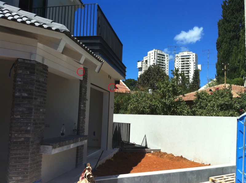

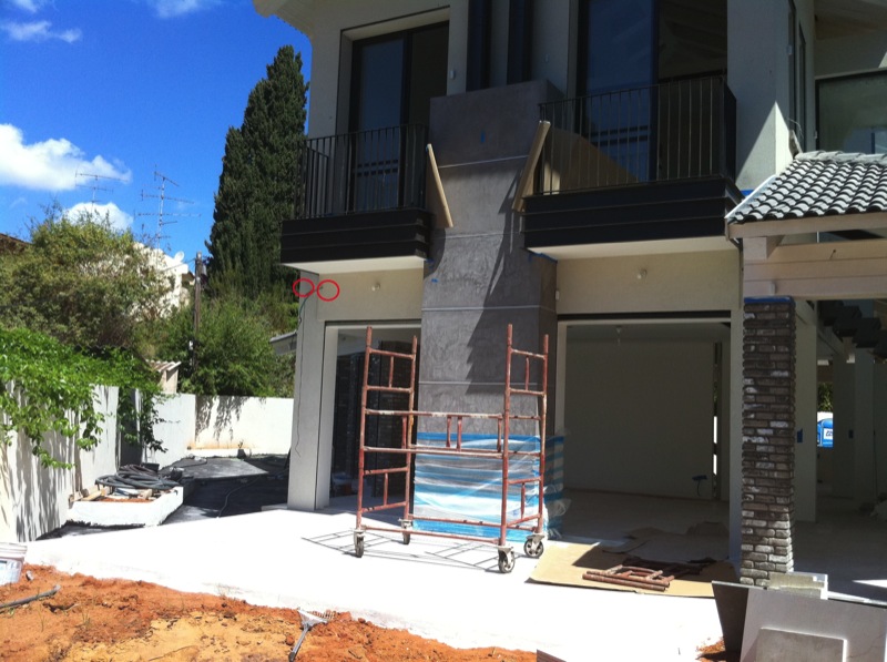

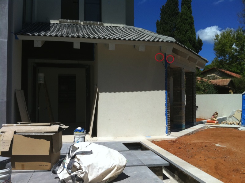

Hi guys, please help me find a suitable 8x PAL cameras that i can install all around the house on the location i marked in red
all i want is to get a good quality image for 25ft-30ft ahead (just to get the entire back and from yard front entrance and car parking) they should be night & day so i guess i have to go with the waterproof bullet IR model.

hi there, the only thing to take into account is the purpose of the system you wish to install. Have you given any thought to viewing angles and or lens sizes as buying 8 of the same type might not deliver what you require.
Hi omer78. one thing i would say is stay away from you dvr you have listed. but your make of cameras is good. but with your cameras being so low i would look at CNB V/domes. using bullet cameras that low is not a good idea as the brackets are not very good on bullet cameras. were are you (if your looking for pal ) because with that sun in your pictures your not in the uk .... looks like spain ???

read the threads the cnb 24vf will surve you will the dome is slighly tinted and it does well in the sun.

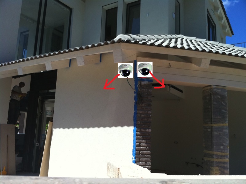

Hi, i have looked at the model you told me, i'd like to know if placing 2x dome\bullet cameras like in the picture bellow is a wrong concept
and only a single camera would do the work.
Just to make it clear, it's not that im obligated for 8x camera configuration, it's just that i got an offer from someone to wire the house in 8x camera and thats what i have installed.
if you guys will tell me that 4x camera config can be surely enough for 360 degrees cover i wont buy more that what i really need.
Another thing is that the all camera will be installed around 10ft high so i assume that the angle won't be wide comparing to a higher installation.
