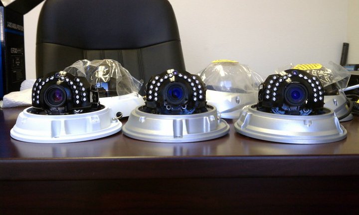

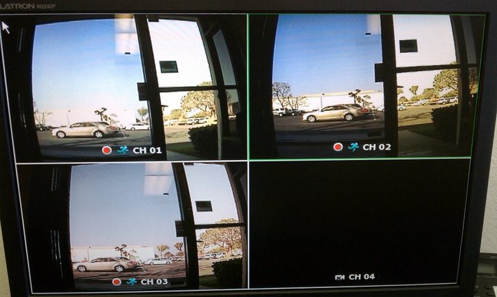

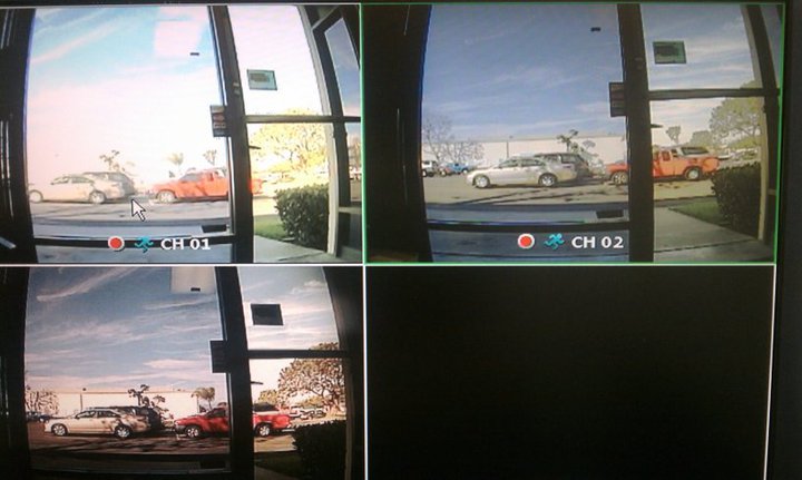

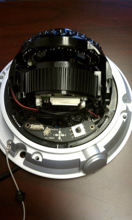

Huviron 0 Posted October 26, 2010 (edited) As I promised I took a few pictures from comparison. One with Sony Effio-P 700TVL, one with Pixim DPS 540TVL, and one with Huviron Gen2 600TVL. You guy guess which one is which. ***Please note*** I'm not saying one is better than the other as they are all our cameras. All the cameras are tested on Huviron SK-R412/4 DVR (Full D1 @30FPS/CH Resolution), and LG 24" LCD monitor. Even with our updated DVR, it could not show drastic difference between 700TVL and 540TVL. However, with direct conection to our CCTV specific monitor, difference was a bit more noticeable. ******************* All three cameras on our Vandal V261 Body Effio-P 700TVL Pixim DPS 540TVL Huviron GEN 2 DSP 600TVL WDR on WDR off Can you guys tell which one is which? OK Let me give you the answer now Ch1 - Effio Ch2 - Gen2 CH3 - Pixim Looks like picture doesn't show much detail. In person, Ch1 picture looked pretty good and showed the best WDR performance. Please note, Only Ch1 shows Visa/Master logo with WDR on. Ch2 displayed best color values and Ch3 looked kind of washed out pictures but still with good detail. Overall my score is: Picture(Resolution) Quality: Effio > Gen2 > Pixim Colors Values: Gen2 > Effio > Pixim WDR Performance: Effio > Gen2 > Pixim Night with IR ON performance: Pixim > Gen2 > Effio Night with NO IR Performance: Effio > Gen2 > Pixim Price: Gen2 (Cheapest) > Pixim > Effio (Expensive) Edited October 28, 2010 by Guest Share this post Link to post Share on other sites
leeline88 0 Posted October 27, 2010 I guess CH02 is Effio 700tvl,Am I right? Share this post Link to post Share on other sites
cglaeser 0 Posted October 27, 2010 If you get access to a Sony EFFIO ExView HAD II CCD camera, please be sure and post your review of low-light performance. Best, Christopher Share this post Link to post Share on other sites
rory 0 Posted October 27, 2010 I tired a pixem last night and it was awful, had all kind of artifacts, same with when I tried it when they first came out a few years ago, Id never waste money on one of those chips again. Otherwise cant say as cant see it that clear. Seems #1 has some digital artifacts so maybe that is pixem? #3 looks like the best picture in this case. Share this post Link to post Share on other sites
Huviron 0 Posted October 27, 2010 If you get access to a Sony EFFIO ExView HAD II CCD camera, please be sure and post your review of low-light performance. Best, Christopher I would rate Pixim the best at low-light followed by Gen2 and then Effio gets a bit too bright with IRs on. But all these three cameras have ICR filters so they were all pretty good. Share this post Link to post Share on other sites
Huviron 0 Posted October 27, 2010 I tired a pixem last night and it was awful, had all kind of artifacts, same with when I tried it when they first came out a few years ago, Id never waste money on one of those chips again. Otherwise cant say as cant see it that clear. Seems #1 has some digital artifacts so maybe that is pixem? #3 looks like the best picture in this case. Rory, I know what you mean, and Yes, the picture did not really reflect what I saw in person. When I connect cameras directly to the CCTV specific monitor, there's no doubt Effio had the best resolution. However, most people still have to use DVR anyways, I had to test them with DVR. Even with our newest DVR with updated FW, the result was quite surprising. Anyways, here's the result: #1 is Effio, #2 is Gen2 and #3 is Pixim Effio shows a bit of artifacts, but this could be because default sharpness value was set to a bit too high. I turned down the sharpness value and it gets better but I took the pictures when all cameras are at default value to be fair. In person, colors on Pixim looked a bit washed out but can't tell from the picture. Gen2 was kind of in between. Effio had the best WDR performance as it uses Dual Scan CCD. Gen2 and Pixim showed about the same WDR performance. Not too bad for Gen2 as it uses single scan CCD and least expensive of all three. At night, Effio (800TVL BW) and Gen2 (700TVL BW) showed better pictures than Pixim probably due to their high BW TVLs but with IRs on, Effio gets a bit too bright somehow. (All three cameras have same IRs) Overall, each cameras have their own pros and cons. While Effio has the best resolution, it's most expensive of all and I don't know how many DVRs can display 700TVL very well. Hope this helped you guys. Share this post Link to post Share on other sites

Huviron 0 Posted October 27, 2010 (edited) Huviron, do you mind me asking what CCD you used with the Effio sample? Also, what is your gen-2 chipset paired with? Assume your chaps will be at CPSE? Will Eric be there? Squizz. Squizz, Sony 960H Super HAD CCD II on Effio Sony 760H Super HAD CCD II on GEN2 Obviously DPS Sensor (CMOS) on Pixim We will be at the ISC East this year as we have to support our OEM customers. I believe a couple people from our Headquarter(Korea) will go to CPSE. I just double checked and Eric will not be at CPSE this year. Thanks Jay Edited October 27, 2010 by Guest Share this post Link to post Share on other sites

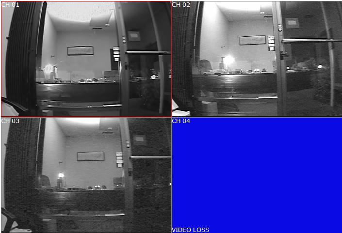

Huviron 0 Posted October 28, 2010 (edited) I will test them again with IR's off tonight. I have no doubt Effio will be on the top. Yes, looking forward to your tests with no IR. Best, Christopher OK here's the test result with NO IRs. Sorry I forgot to turn the monitor off!! But you can still see the difference very clearly. Look how clear Sony Effio is at night(CH1) and Pixim(CH3) shows quite a bit of noise on the picture. Again Gen2 (CH2) kind of in between two. Edited October 28, 2010 by Guest Share this post Link to post Share on other sites
cglaeser 0 Posted October 28, 2010 But you can still see the difference very clearly. Yes, considerably cleaner image. Thanks for posting. Best, Christopher Share this post Link to post Share on other sites
rory 0 Posted October 28, 2010 yeah the pixem i tried was terrible in low light, all kind of noise and strange artifacts. Share this post Link to post Share on other sites
