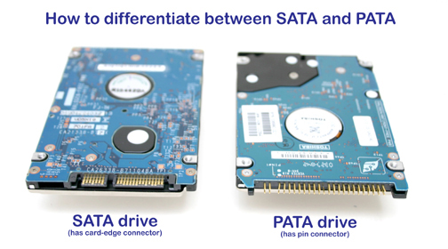

Soundy 1 Posted November 4, 2010 hi i would like to know if there is a special type of ide hard drive for my dvr (like the sata hard drives) or should i just get a normal ide computer hard drive and put that in? Impossible for anyone to say without knowing at least the make and model of your DVR. Some are very forgiving and will work with almost any drive with the right interface (PATA or SATA); some are very picky and only work with a few drives. Usually the DVR's manual will list what drives are supported. ps, what is the difference between the types of ide hdd? Depends on what you mean by "types"... PATA vs. SATA? Both are IDE (Internal Drive Electronics). PATA (Parallel ATA) have a wide 40-pin data connector; SATA (Serial ATA) have a 7-pin card-edge type connector: Share this post Link to post Share on other sites
Birdman Adam 0 Posted November 4, 2010 PATA drives also use normal Molex power connectors while SATA drives have a special SATA power connector. SATA is also a lot faster. Share this post Link to post Share on other sites
