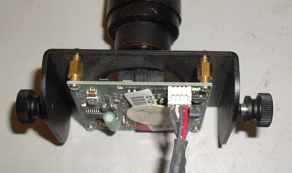

While clearing my garage i found one Visage Dome Camera VRDN550IR
Right, i took the cover off and now i am stock, it does not have any connections coming out see pictures and you might help to fiddle things to the right way.

I believe that 4 pin connection that you have the closeup on is the one that a little connector connects to and it has a video and power cable attached to it and on the other end is a BNC connector and power plug. You may be able to contact the manufacturer to see if you can get that wire. Or, if you want to do it the redneck way, you can find out the pin assignment for each pin and solder some wires to it and somehow make the wires stay connected.
Here is what one of those connectors looks like connected to one of our Wren board cameras:

Thanks SEANHAWG for very details answer,
Does that mean that BNC connector runs video signals and power at the same time or it should be 2 different connectors? because all I can see in the connector that there are 4 contacts and nothing else?
Confused
Yes on the other end of that cable that you cannot see in the picture is a BNC connection AND a power connection. 2 seperate cables. 2 of the pins have to do with video and the other 2 have to do with power
