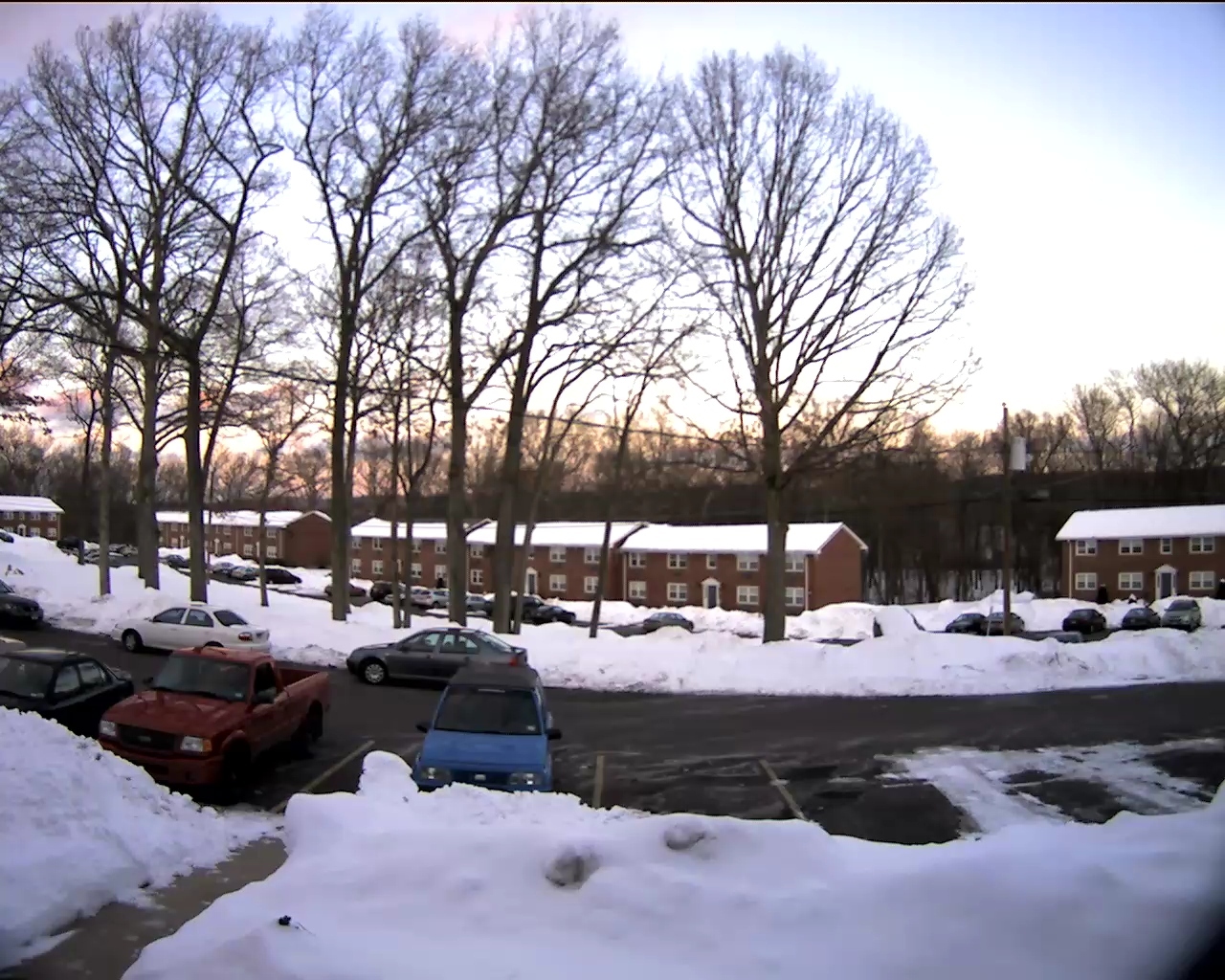

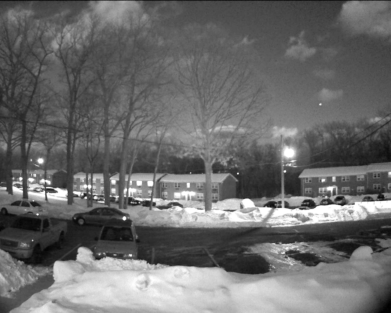

Just started playing with the BL110D 1.3MP. Not bad but have a couple of concerns. One, every time you open the lens, you have to replace the silica beads packet to prevent fogging of the cover. The other is the IR LED's. Once they kick in, anything in the middle of the shot closer than 3 meters is really washed out. Not a closeup unit.
Dusk Shot
Thanks for the pix I will get one of these and try it out. Looks to me that the picture quality should be OK for what we are doing the 3' limit should be no problem as these will be mounted on the 2nd story of a building
That is a 3 meter (10 foot) consideration but as it'll be mounted on the 2nd story, as you said, it shouldn't be an issue. Also, if you have adequate lighting, you can disable the black & white if needed.
