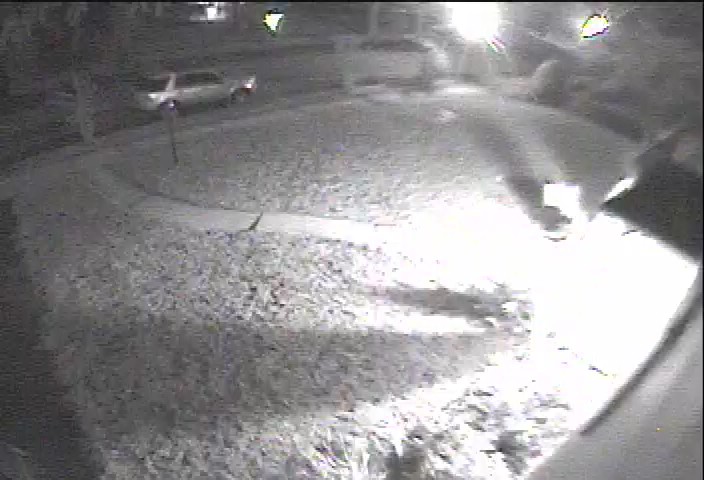

Rory you seam to find images like this useful. Myself and my customers do not.
CNB VCM-24VF
My customers want this.

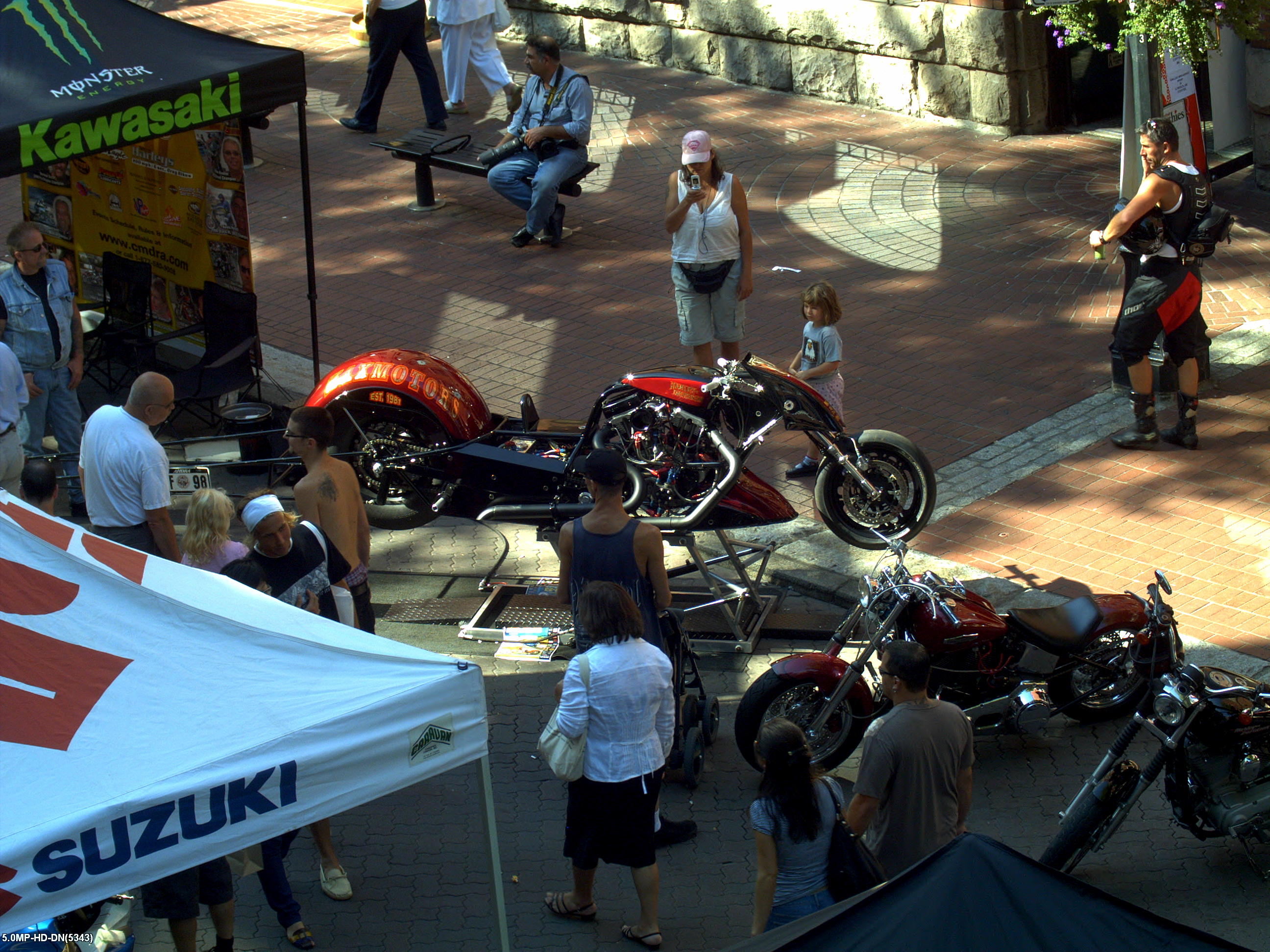

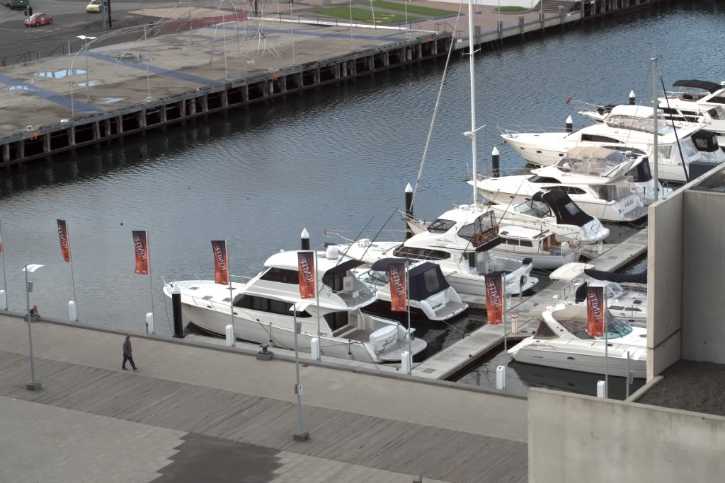

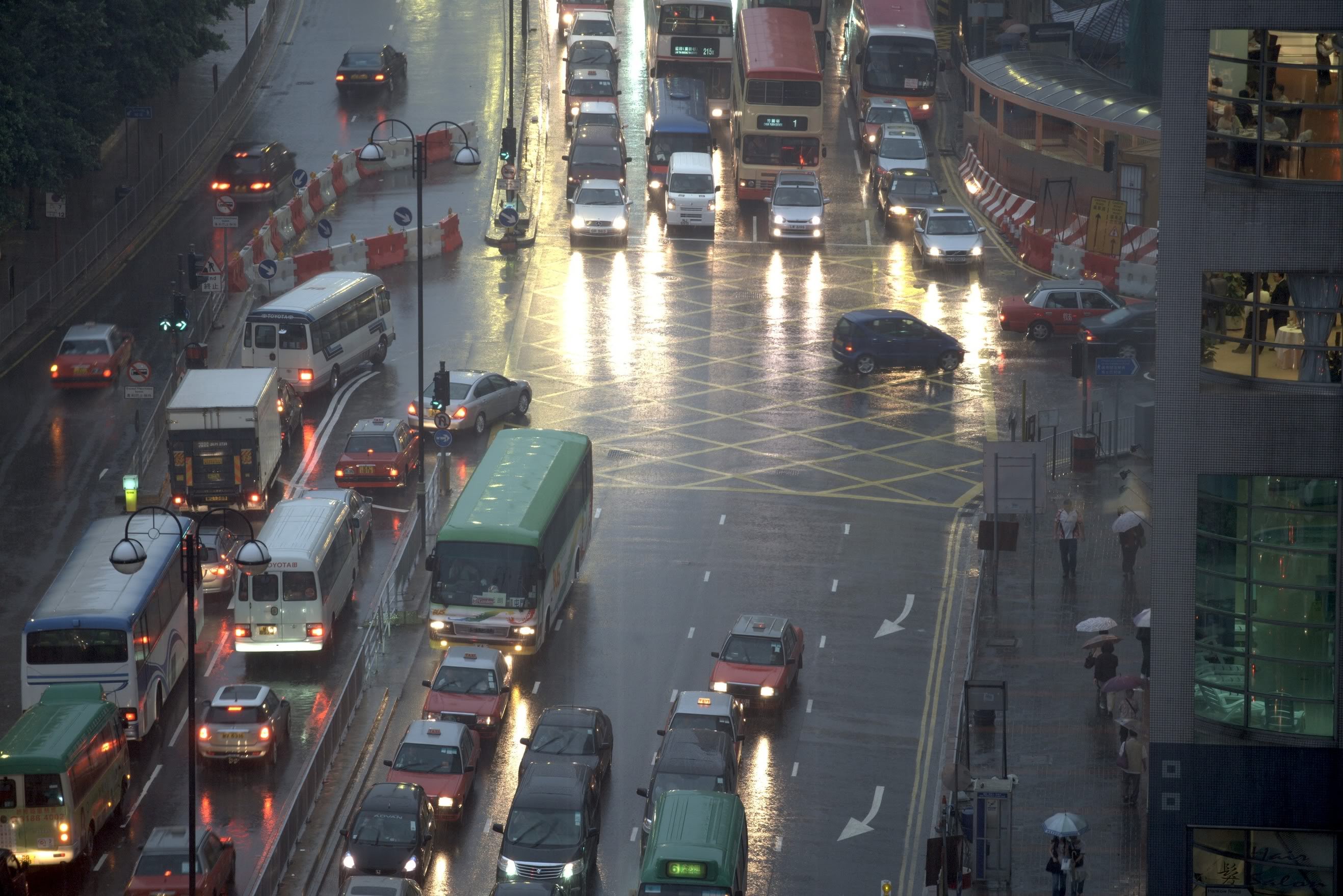

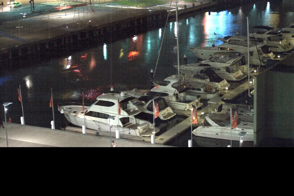

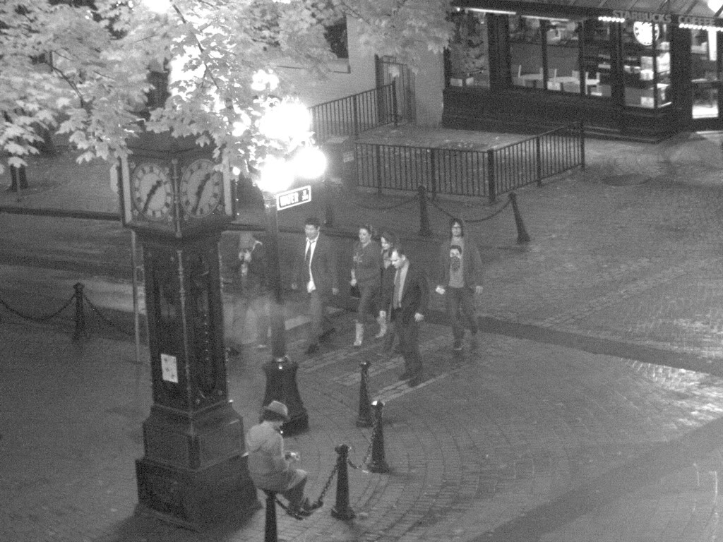

Here's a few Avigilon megapixel nightshots, courtesy of megapixelman's photobucket.
Pro daytime for comparison :
Pro color (mono 16MP is even more sensitive at night) :
Non-pro :
