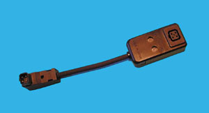

tomcctv 187 Posted August 6, 2011 Sorry i imformed you wrong.I am useing the 9v battery just to set up the zoom . The iris is controlled from the 1amp power supply hi. your camera needs 12v and your lens also needs 12v (it needs 8v just for the iris to work) the problem you have is the wrong equipment i would remove your motorized lens. you have no zoom control or vocus control and no iris control you can buy 1 of these , but it will cost you alot more than a standard 50mm lens. fit one of these and you will be good to go. Share this post Link to post Share on other sites
