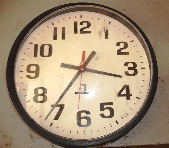

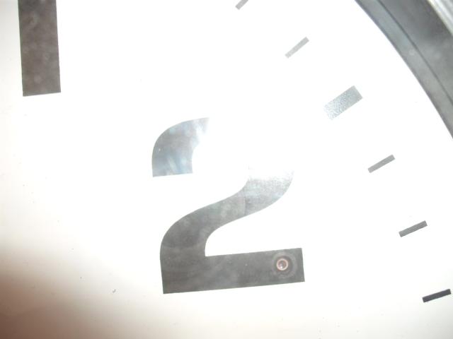

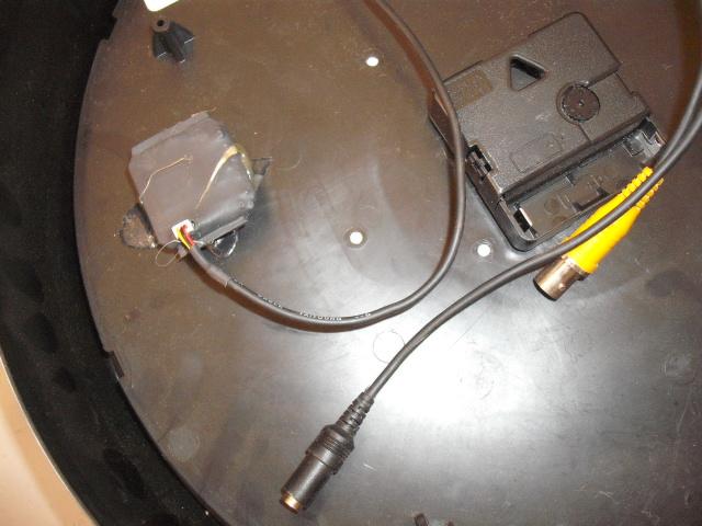

If you want covert then get a good pinhole board camera. It takes covert to a whole new level. Of course your limited to a fixed lens but if short distances are all you need them for them that shouldnt be a problem. The opportunities are endless, you just need to find a hole small enough for the pinhole lens to look through. Here is a clock we got in from one of the places we contract with. I was wondering why the heck they shipped us a clock in for, then I looked at the back and there was a Filtech pinhole board camera attached to it. Someone drilled a small hole in a regular clock and glued the darn thing to the clock:

That covert clock camera is one of the best I've ever seen. If you hadn't shown a close up of the hole,
I might never have spotted it, ( well OK maybe after a while). I was aware that the pinholle cameras
were the really useful for peering through tiny holes. I have seen one that is hidden in a IP65 junction box
seen them in cereal boxes and of course my favorite, in a false ring-binder file on an office shelf.

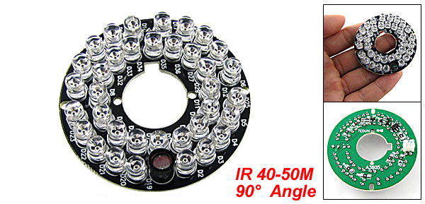

It's easy enough to add light in any given situation. IR boards with a hole for the lens are easily available from many sources,and very cheaply. You can use a low light board camera in almost complete darkness and still get a useful picture without additional IR light.
