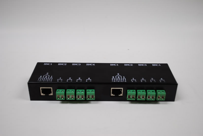

tomster 0 Posted May 17, 2011 Hi all, I am running a 16 channel Bosch DVR. I wish to add a remote 8 channel DVR for data redundancy in the event the main DVR walks out the door. My DVR has 16 BNC outputs (one for each channel). I was going to pick the 8 most important channels and output them to a remotely located 8 channel DVR that would be housed in a lockbox. The thought of running 8 seperate coax cables to the remote DVR would be a pain. I just so happened to have run a few extra cat5 cables from the current DVR to where I will mount the remote DVR. So I was thinking of using an 8 channel balun like the one pictured below You see these passive units on ebay for about $20-$30. My total run distance is about 60 feet. Does anyone have any experience with these units and can you recommend them or other baluns? Thanks for the help! Tom Share this post Link to post Share on other sites
tomcctv 187 Posted May 17, 2011 Hi ebay is hit and miss ... most times a miss. you need to run 2 cat5 anyway so for the cost i would just use single baluns. one other thing you need to look at is the main 8 cameras .... you are best running them to your hiden dvr first. if they do get to your main dvr and pull all cables out you will also loose the 8 running to your second dvr. Share this post Link to post Share on other sites
tomster 0 Posted May 18, 2011 Excellent information! I looked and saw that the single channel baluns are the better way to go. Do you recommend any over another or is ebay ok for that? Thanks! Share this post Link to post Share on other sites
Soundy 1 Posted May 18, 2011 I used two of these on one job - worked great and helped make a nice, clean install: http://www.muxlab.com/products/vec_quad_video_balun.htm# Share this post Link to post Share on other sites
