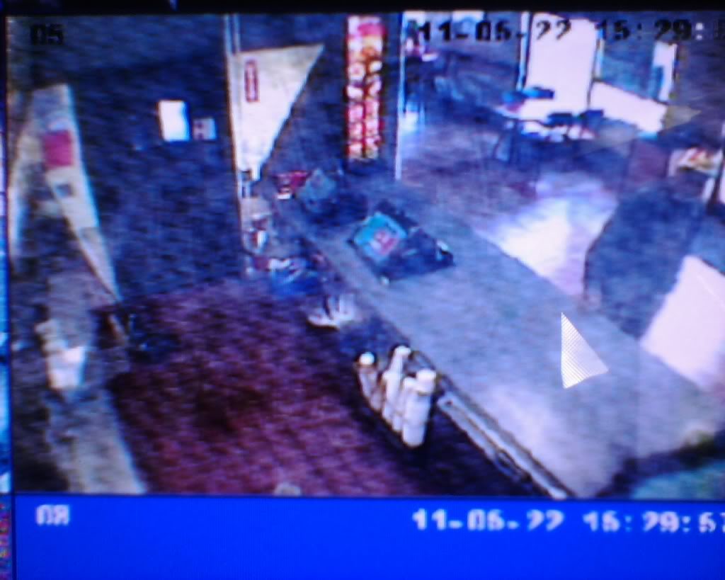

Here is a pic - hopefully it comes through. The white moves on the actual, but from the static picture here you can definitely get the idea...
All those long white lines (I see about 6 in the picture) also move. They seem to be defined ghosting images of actual images in the shot. Then the more cloudy interference is with it as well.

It's very difficult to determine from this picture if the problem is ghosting or humbars.
A very common cause of ghosting is improper termination. All 16 channels?
Humbars could be indicative of a ground loop issue....
I cannot say definitively from this image which it is?
