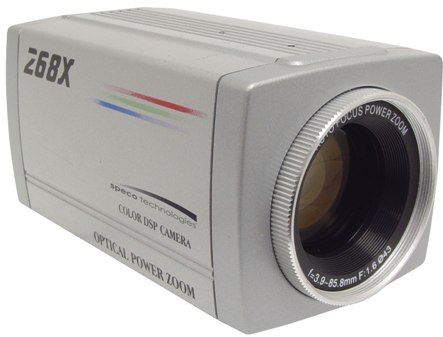

Bluzman23 0 Posted June 11, 2011 Hi All, I have a home system, which I am looking to add some form of plate capture to. Can anyone recommend a good cam not looking to go full on nuts like the Extreme CCTV bad boy, just looking to have the abality to grab some plates . I currently have a speco tech CVC652-HZ which is a fixed zoom type cam I was wondering if anyone is familiar with it, or if it were capable of being used for my plate capture. Also do I need to intergrate some form of software or do I just set up motion through the cam or DVR to just record the exact location the plate will be passing through? Currently I have a 8 Channel everfocus Dvr model Ecor8D Any Help or idea's would be great. Share this post Link to post Share on other sites

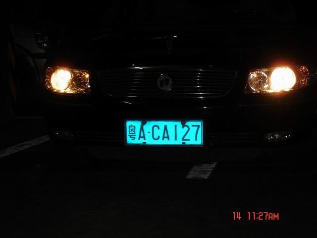

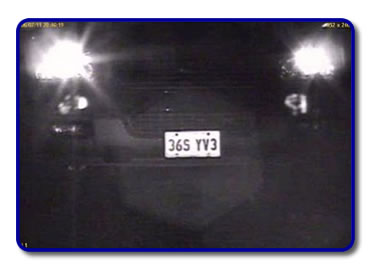

tesc_cctvpro 0 Posted June 11, 2011 License plate viewing is one of the most challenging aspects of surveillance --- especially if you are going to be facing headlights in the night time, creating such high contrasts that a lot of WDR cameras will not even be able to process. Then you need to make sure you are using a progressive scan camera as opposed to an interlacing camera. The camera you have uses a 2:1 Interlace scanning method, so I'm not able to say how well it's going to handle charachter definition on a moving target. Your reference to software integration - raised the possibility that you might be talking about number plate processing as opposed to straight forward viewing - am sure you are familiar with OCR technology when scanning documents on a home scanner ----- the text cannot be processed in any way, from a picture. We have used this camera before with good results, in what I would call low to mid end application. Some of these cameras are designed to handle the high contrast, and another design utilizes masking of headlights or very bright areas - effectively blacking out the head/tail lights. The short answer is that that is not an ANPR LPR camera as far as I can see! If you don't want to process the plate text, and you aren't going to be facing night time surveillance ---- you could set that camera up to get a good shot of the plate ------ Share this post Link to post Share on other sites

tomcctv 189 Posted June 11, 2011 If you don't want to process the plate text, and you aren't going to be facing night time surveillance ---- you could set that camera up to get a good shot of the plate ------ thats interesting. that image was not taken with this camera. it was taken with a camera of this spec. it was taken via a box camera with same spec as the CVC652-HZ SPECIFICATIONS Item Specification Image sensor 1/4 type EXview HAD CCD Number of effective pixels Approx. 440,000 pixels Lens 18 x zoom, f=4.1 mm (wide) to 73.8 mm (tele), F1.4 to F3.0 Digital zoom 12 x (216 x with optical zoom) Angle of view (H) 48 deg. (wide end) to 2.8 deg. (tele end) Minimum working distance 35 mm (wide end) to 800 mm (tele end) Sync system Internal/External (V-Lock) Minimum illumination 0.7 lx (typical) (50 IRE) S/N ratio More than 50 dB Elctronic shutter 1s~1/1000s White Balance Auto, ATW, Indoor, Outdoor, One-push, Manual Gain Auto/Manual (-3 to 28dB, 2 dB steps) AE control Auto,Manual, Priority mode, Bright, EV compensation, Back-light compensation EV compensation -10.5 to +10.5 dB(1.5 dB steps) Back-light compensation On/Off Privacy Zone Masking On/Off (24 positions) Flicker cancel -- Focusing system Auto (Sensitivity: normal, low), One-push AF, Manual, Infinity, Interval AF, Zoom Trigger AF Picture effect E-Flip, Neg. Art, Balck & Whiter, Mirror Image Camera operation switch Zoom tele, Zoom wide Video output VBS: 1.0 Vp-p (sync negative), Y/C Output Camera control interface VISCA (TTL signal level), baud rate: 9.6 Kb/s, 19.2Kb/s, 38.4 Kb/s, Stop bit: 1/2 selectable Storage temperature -20 to 60 deg. C Operating temperature 0 to 50 deg. C Power consumption 6 V to 12 V DC, 1.6 W (motors inactive) 2.5 W (motors active) Mass Appro x 225g Dimensions (L)120mm x(W)62mm x (H)65mm Share this post Link to post Share on other sites
tesc_cctvpro 0 Posted June 11, 2011 If you don't want to process the plate text, and you aren't going to be facing night time surveillance ---- you could set that camera up to get a good shot of the plate ------ thats interesting. that image was not taken with this camera. it was taken with a camera of this spec. it was taken via a box camera with same spec as the CVC652-HZ SPECIFICATIONS Item Specification Image sensor 1/4 type EXview HAD CCD Number of effective pixels Approx. 440,000 pixels Lens 18 x zoom, f=4.1 mm (wide) to 73.8 mm (tele), F1.4 to F3.0 Digital zoom 12 x (216 x with optical zoom) Angle of view (H) 48 deg. (wide end) to 2.8 deg. (tele end) Minimum working distance 35 mm (wide end) to 800 mm (tele end) Sync system Internal/External (V-Lock) Minimum illumination 0.7 lx (typical) (50 IRE) S/N ratio More than 50 dB Elctronic shutter 1s~1/1000s White Balance Auto, ATW, Indoor, Outdoor, One-push, Manual Gain Auto/Manual (-3 to 28dB, 2 dB steps) AE control Auto,Manual, Priority mode, Bright, EV compensation, Back-light compensation EV compensation -10.5 to +10.5 dB(1.5 dB steps) Back-light compensation On/Off Privacy Zone Masking On/Off (24 positions) Flicker cancel -- Focusing system Auto (Sensitivity: normal, low), One-push AF, Manual, Infinity, Interval AF, Zoom Trigger AF Picture effect E-Flip, Neg. Art, Balck & Whiter, Mirror Image Camera operation switch Zoom tele, Zoom wide Video output VBS: 1.0 Vp-p (sync negative), Y/C Output Camera control interface VISCA (TTL signal level), baud rate: 9.6 Kb/s, 19.2Kb/s, 38.4 Kb/s, Stop bit: 1/2 selectable Storage temperature -20 to 60 deg. C Operating temperature 0 to 50 deg. C Power consumption 6 V to 12 V DC, 1.6 W (motors inactive) 2.5 W (motors active) Mass Appro x 225g Dimensions (L)120mm x(W)62mm x (H)65mm I never said it was! I used the two pictures to highlight the problems of night time plate capture ----pre-supposition always clouds rationality! That Camera as I said is a low end application: This image comes from a box camera from the same manufacturer: Share this post Link to post Share on other sites
tomcctv 189 Posted June 11, 2011 am total confused by your post. first image, jetwiew your camera that you use, busytrade second eclips picture image , alibarba do you not have a picture of the camera that has taken the view. the jetview image is taken with a camera that has them same spec as the spectra. as they both use the same manufactura. Share this post Link to post Share on other sites
tesc_cctvpro 0 Posted June 11, 2011 am total comfused by your post. first image, jetwiew your camera that you use, busytrade second eclips picture image , alibarba do you not have a picture of the camera that has taken the view. the jetview image is taken with a camera that has them same spec as the spectra. as they both use the same manufactura. Why would you be confused --- I am not brand promoting! The first image highlights the high contrast levels involved in night time plate capture. The second image from my favored IP/Analytics provider illustrates the specialized function of processing characters as opposed to images. The third is an example of a camera we have used for low budget applications --- by the way it's manufactured by Lonrun Di-te in Guangzhou China, as is the last Image in the other post. The animated image illustrates the technique of headlight masking. I have no interest in selling a product here for this low level application and potentially low margin return --- am just taking the time to point out challenges of night vision plate capture. I think the confusion arises from your tendency to post images to promote a product - hence your confusion when you imagine that's the sole purpose of posting images on the forum. Share this post Link to post Share on other sites

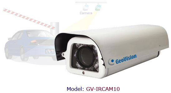

tesc_cctvpro 0 Posted June 11, 2011 @tomcctv ----- here's the camera that took that first picture Share this post Link to post Share on other sites
