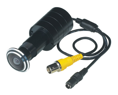

Birdman Adam 0 Posted June 26, 2011 I think I could identify the guy if I saw him again, but only because he looked up. 1. TVL does not matter much. NTSC signal (how the video is transmitted), maxes out at 720x480, so any camera with TVL higher than 480 may be good, but it isn't necessarily better than a camera with exactly 480TVL. Any decent camera over $100 will work well for this close-quarters recording. 2. The camera needs to be lower, preferably at face level. It would be best for you to put it in the door (like a peephole). There are many places that sell great cameras for this. 3. What matters much more than TVL is getting a good recorder (DVR). I'm not good at that so others can chime in! Share this post Link to post Share on other sites

NotoriousBRK 0 Posted June 27, 2011 The camera needs to capture video that will prove without reasonable doubt that the person in the video is the person being tried. Why? What exactly are you trying to accomplish with this cam? What is the crime risk that you are anticipating? The typical front door camera would capture very little crime footage, so even the sharpest picture isn't going to necessarily provide the evidence footage you think it will in a majority of cases. The front door camera I want to provide facial identification. I fewl my neighbors camera or DVR is not sufficient in quality. This is why I want your expert opinions. 1. How high would you mount the camera? 2. Is TVL beyond 480 really not worth it as mentioned by one of the posters? Thanks. OK, but I think you are over-valuing the facial recognition part is all I was trying to say. You might need more than 1 camera if you *really* want to cover all options. But I would mount at least 1 camera at about 5.5' high, looking slightly up at the point where a person would most likely stand on the porch. And yes, the high TVL count cameras are mostly marketing gimmicks. Personally, I think that if you really think you need such high quality images an analog camera/DVR combo might not be the best option anyway... Share this post Link to post Share on other sites
