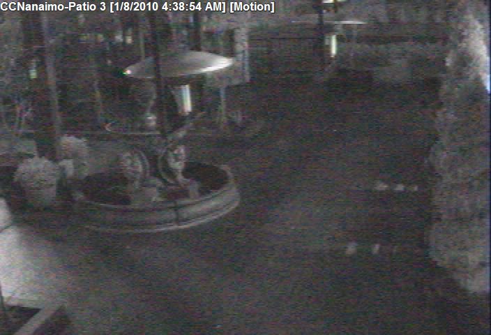

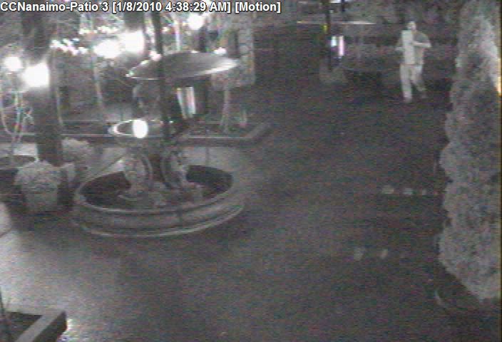

This is one we put on a restaurant patio... first with a few 60W bulbs:
And here the only light is a little bit filtering through the blinds on the window to the right, and a street light about 100' away to the left:

Awesome, thanks! I think my situation is like your second screenshot, maybe even a little more light, so that's what I need!

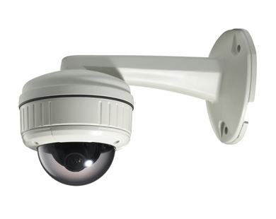

I assume the camera doesn't come standard with a wall-mount?
The VCM-24VF is the same as the VBM-24VF but it has a larger base for connections.
Might also want to look at that model.
