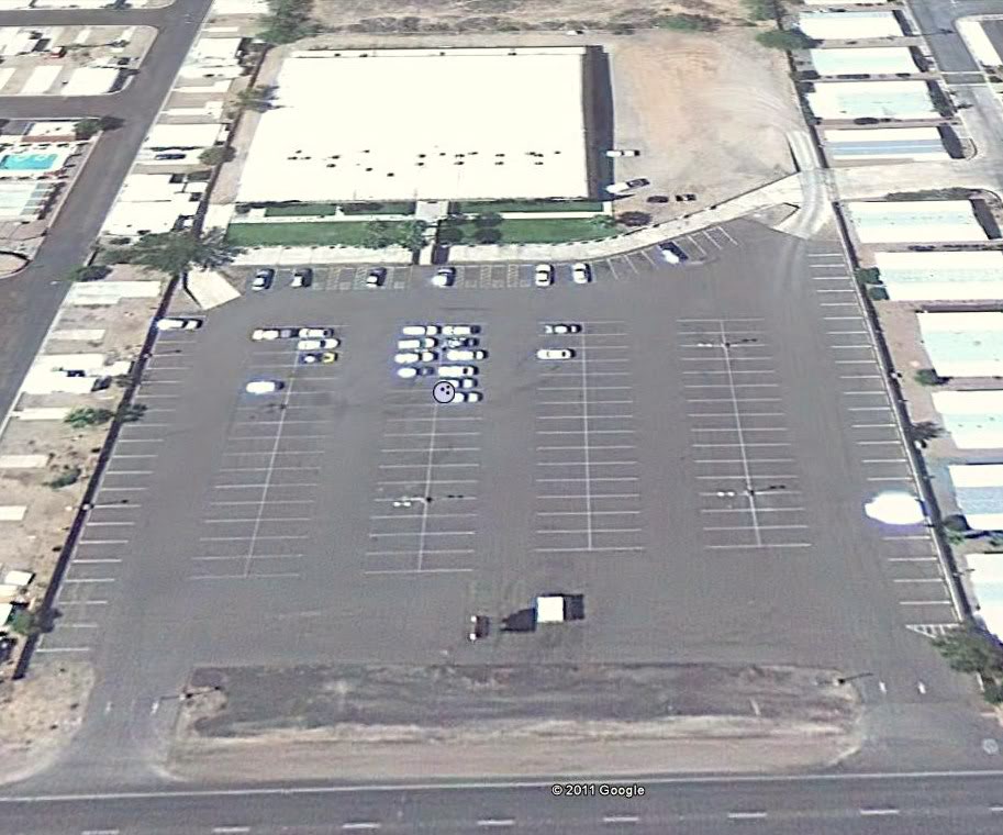

higg 0 Posted September 6, 2011 Long of the short. Basically I work in a bowling alley. The owners spent a large amount of money on an audio, and security system. The installers food a sub par job to say the least. Dvrs 3 spec tech 16 ch tn series 1 speco tech 8 channel th series newly added Current known camera models Honey well hd51, and hd70 or 73 the ir fixed model Various other makes and models in parking lot. newly added Nuvico cb-hd39n-l Cnb weatherproof it day/night So we have 16 cameras in the parking lot. The cables were ran in pvc pipes to light posts, 4 posts 4 cams each. The pipe from the building to the first pole filled with water. I think the pipe cracked and the irrigation fills it 4 days a week. I want to take the cameras down and install inside the building. So I need to cover the lot. My idea 3 higher end ptz cameras(bullets or dome). Size 220 ft wide(parallel to face of building) 250 ft out. Starts roughly 35 ft from building. 15 ft high camera placement. The weather is dry and most of the time(in az) Parking lot is decently lit. Repairing pipe and replacing wire would cost roughly 1500 if I do the labor. I really don't wanna do it. So basically I need suggestions when it comes to cameras. Will three work? I can probably spend 3500 to 4k. Also do the ptz cams run their own cycles constantly? I would need wired. Can a camera be rented, to test? I am on a phone, I am more then happy to call and talk if it would be easier... on here is fine as well. Thanks Aaron Share this post Link to post Share on other sites

Soundy 1 Posted September 7, 2011 So we have 16 cameras in the parking lot. The cables were ran in pvc pipes to light posts, 4 posts 4 cams each. The pipe from the building to the first pole filled with water. I think the pipe cracked and the irrigation fills it 4 days a week. I want to take the cameras down and install inside the building. So I need to cover the lot. My idea 3 higher end ptz cameras(bullets or dome). Size 220 ft wide(parallel to face of building) 250 ft out. Starts roughly 35 ft from building. 15 ft high camera placement. The weather is dry and most of the time(in az) Parking lot is decently lit. Repairing pipe and replacing wire would cost roughly 1500 if I do the labor. I really don't wanna do it. So basically I need suggestions when it comes to cameras. Will three work? I can probably spend 3500 to 4k. Also do the ptz cams run their own cycles constantly? I would need wired. Hard to say without a drawing of the layout, but generally, yes, three PTZs should be able to cover all that, although you'd probably want to make sure you use high-quality models with good optics and a high optical zoom factor (ignore digital zoom ratings, it's a useless function on analog cameras). The downside is, they can still only see one area at a time - you could program a tour or pattern for each one to scan, but it will still only be looking in one direction at any given time. If there's a guard on-duty who can watch an overview camera and then then manually steer the PTZs for a closer look, that may not be s Can a camera be rented, to test? Never seen a CCTV camera for *rent*, but an integrator or supplier may be willing to loan one for testing, or install one on a temporary "demo" basis. Share this post Link to post Share on other sites

Soundy 1 Posted September 7, 2011 Just make sure both cameras and DVR(s) support Pelco D or P protocols... most *good* cameras can accept a wide range of protocols, but almost all of them will take Pelco D and/or P, and the majority of even older DVRs should support it as well. Keep in mind that you'll have to get signal to them somehow... if you're planning to use existing wiring (power and coax) you may have to look for something that supports "Coaxitron" or another up-the-coax control method. Also, existing power supplies may not be beefy enough for better PTZs, especially if they have built-in heater/blower. Share this post Link to post Share on other sites
higg 0 Posted September 7, 2011 I have to run new cables. I figured on choosing a cable when I found the camera that would fit budget and capability needs. I plan on cameras costing about 1000 to 1200 each. Still researching controller, and service monitors(probably end up using my phone or a smaller tv. This project has been crazy. Repairing the sound system was a nightmare. Now the security system has taken it to whole different level. Currently learning back focusong. Have to buy a filter tomorrow. Then figure out how to solve staying in nightvision problem, on the Nuvico's and Cnb's. Gotta love a challenge. Share this post Link to post Share on other sites
higg 0 Posted September 9, 2011 Here is a link to Google maps. I couldn't use a picture made on ny phone. http://maps.google.com/maps?gl=us&q=mesa+east+bowl&sll=33.363514,-111.761072 Use sat view, it is labeled a (mesa east bowl) 9260 east Broadway rd mesa az 85208 Edited full message. Share this post Link to post Share on other sites
