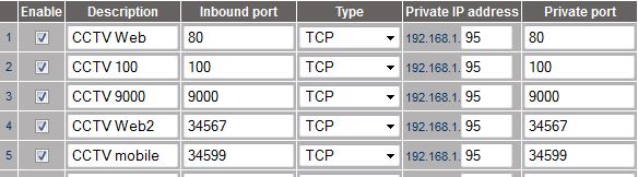

time2innov8 0 Posted September 24, 2011 On my belkin router I have the following configuration for the port forwarding: Share this post Link to post Share on other sites

time2innov8 0 Posted November 13, 2011 pwalton, Your answer to enable the second stream in the encoding menu has sorted my problem accessing the cnm dvr using the meye app (both iphone and android) I have checked the port forwarding now that I have the apps working, for mobile access it is only necessary to forward the mobile port (34599 in my system) time2innov8 Share this post Link to post Share on other sites
