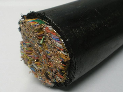

tomcctv 187 Posted October 18, 2011 could cost a fortune in baluns. Share this post Link to post Share on other sites
ljarrald 0 Posted October 18, 2011 blimey! is that 40 core? looks more like 400. Share this post Link to post Share on other sites
tomcctv 187 Posted October 18, 2011 blimey!is that 40 core? looks more like 400. 500 just good to have some spare Share this post Link to post Share on other sites
ljarrald 0 Posted October 18, 2011 blimey!is that 40 core? looks more like 400. 500 just good to have some spare ahaha. what do 500 core cables get used for then? Share this post Link to post Share on other sites
Soundy 1 Posted October 18, 2011 okay, that's good to know. is there a standard name for 20/40 core wire? (and do baluns care about the thickness of the wire?) "Multicore"? I dunno, big bundles like that, we've normally referred to by number of pairs, as the wires ARE in pairs internally (25-pair, for example, was common for old-style multiline phone systems). blimey!is that 40 core? looks more like 400. 500 just good to have some spare ahaha. what do 500 core cables get used for then? Telephone trunk lines, generally - you'd see them serving entire neighborhoods. Gradually being replaced by a few fiber runs... Share this post Link to post Share on other sites
