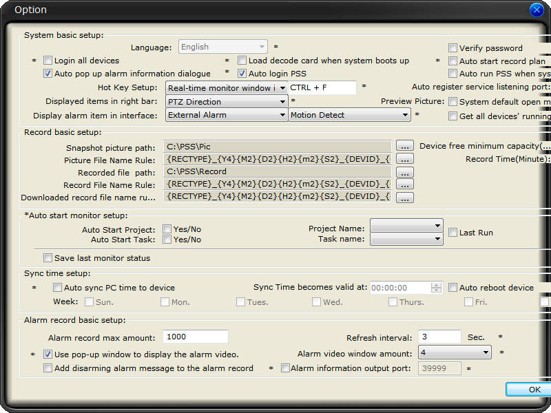

Rory, i presume i can login with admin, admin and setup the temp account, etc all remotely? And which program would you recommend i do the setup with PSS or webviewer?
Secondly, it sounds like you use their stuff alot. With PSS i access it on my high res screen so i have increased the font DPi to 120. When i access the Config setting and Playback screens they are misaligned. Have you experience this and if so, happen to know of a work around? I contacted Dahua but they told me to reduce the resolution, which really isn't an ideal solution.

Unfortunately as PSS uses skins and they dont resize them accordingly, it will always be out of whack at higher DPI settings. There is something they could do in their code to make it work either way, but they either dont know or just dont bother.

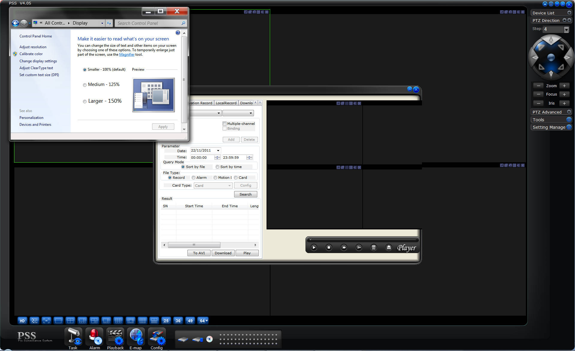

This is strange - I'm using windows and reverted back to 96 DPi (100%) and PSS still appears as below:

switching it to 96 dpi works everytime so not sure why its not working on yours. From looking at your screenshots, the screenshot you are showing is not the dpi setting. what version pss u using? Also, what OS are you using on your computer?

Agreed. I've setup it up a dozen times on Windows Vista/7 computers where I had to reduce the dpi and have never had it not work. Windows 7 does require you to log out and log back in for the resolution change to take place, but beyond that, the PSS screen should appear as normal.

Restarted a few times, during uninstall, reinstall and DPI change - on Win7 64bit you only need to logoff to set change. The only thing i can think of is I did play with fonts but have reset all of those back to default by downloading a new windows theme... 9 point. Reinstalled after that too, etc

It's version PSS 4.05 downloaded form Dahua website, Win 7 64bit

I know, that's why i can't figure out why it's not picking up the 96DPI setting. If i increase DPI, skewing gets worse, when i reduce DPI back to 96 it shows as in screen shots.

Actually I just checked and you are right it can be done with skins.
Unzip the following to the PSS skin path.
http://www.bahamassecurity.com/PSSSkinDPI_test.zip
Example PSS Skin Path: C:\Program Files\Pro Surveillance System(EN)\Skin\Default\
May differ depending on your install of PSS and the OS.
It only effects the Options Window in this test.
Let me know if it looks normal after updating with this.

Rory you are a living legend - this is exactly what i was looking for!!! Thank you so much you have no idea how much hassle you have saved me.
I copied your tweaking and have now got the Options Window to fit 120 DPI at 1920x1200 RES. Done the same with the Playback screen. Both look normal now. I imagine there are other areas that will need tweaking, but those are the main ones and at least i know with a bit of tweaking the others can be done as and when needed.

Glad it worked, I will throw together a full skin update for that and put it on my site for download.
