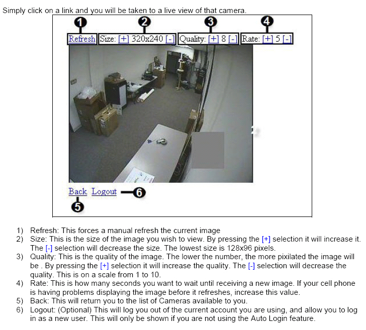

Yes. If you use the "simple" interface, you can choose the video size and the quality, on a scale of 1 to 10, but you can only choose one camera at a time to view. However, you could open up multiple browser windows if you want to view a few different cameras at once.
If we drop in the new gigabit switch and view our cameras with the simple viewer, will the FPS go up inside of the simple viewer. We have 7FPS running right now when viewing the cameras with the simple viewer. Will my FPS increase.
The simple viewer has no idea what kind of switch you have. You just select the image quality and the image size from the simple viewer (scale of 1 to 10), and it increases/decreases accordingly (probably via hard-coded code in the exacqvision web server software), regardless of what switch you have.
Keep in mind here that your bottleneck is your internet speed, not your switch. You'd be hard-pressed to find an internet speed whose upload ability even gets close to 25% of your switch speed, and thats assuming you only have a 10/100 switch! Like I said, my business-class internet only averages about 7mbps upload.
Actually, I just remembered... YOU choose the FPS on the simple viewer -- anywhere from 0 to a big number (I tested and it kept going up above 120 seconds, then I didnt feel like clicking the up button anymore). Then you choose the quality and image size, as well.

Click on image for full resolution. Like I said, the frame rate (#4 in the photo) goes from 0 to at least once every 124 seconds, then I stopped trying.

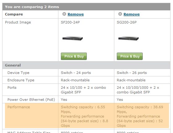

I went to Cisco's site and compared the SF200-24P and it's all-gigabit big brother, the SG200-26P:
Note the Performance ratings - 8.8 gigabits per second is the SF200's "backplane capacity", which is WAY more than enough for your needs, especially since you're not really moving data between the camera ports, but 95% of your data will all be going to the server's gigabit port.
The SG retails for around $600... the SF for a bit under $400. You could spend the extra $200 for the all-gigabit model, but you really wouldn't gain anything from it.
Those are only 12 port PoE, though, he would have to go to the 48 port, which would give 24 PoE ports.
Also, those capacity ratings are for 64 Byte packets, which are the worst-case scenario for a switch, video packets are usually far larger, and don't load switch capability nearly as hard. I use the 8-port version of these models frequently, and I've been happy with them.

Looking at the specs on that, it lists about 1.5Mpps (packets per second) throughput... the Ciscos I listed above state 6.55 and 38.69Mpps. So yeah, it looks like the backplane of that Etherwan switch is a serious bottleneck for the amount of data you're chunking through it (remember, the backplane in my analogy above is the main highway that connects all the on- and off-ramps together, so yes, that's a necessary part of the switch... in this case, your backplane amounts to a dirt horse trail).
