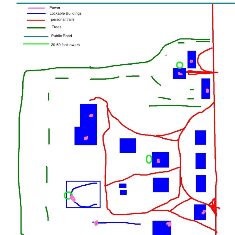

Well my father and I bought a farm this year, and upon taking over ownership of the yard, people have been coming/going and grabbing items, which was fine, we told the previous owners that was alright ( still have 5 more years of dealing with them )
But the neighbors have been coming/going in the yard, and things have gone missing, $600 of wire, and recently we had 500 gallons of diesel fuel delivered to locked tanks, and within 2 days someone stole it all, so we put some money towards a cheapy camera system, and a set of deer cameras to catch people. We are planning on moving the diesel tanks indoor of the big shed, to keep them locked in the building, and out of sight, with a dummy tank outside full of varsale, diesel and whatever else will wreck an engine.
This farm is 40 miles from where my parents live, I currently do not live on the farm, and we try to go over to it, every other day or so in the winter. There is power, and many buildings on this yard, and its spread out over an 1/8 of a mile.
However there is no internet on the farm yard yet, which would be nice to be able to monitor it from here, instead of checking it there. It is on our list though.
I am wondering what cameras/ set up should I be purchasing for permanent security?
There is 14 buildings on this yard site, and 90,000 bu of grain storage between a half ring of bins, a line of bins, and a grain elevator.
There is 3 tv antennas that sit pretty high, and all the important buildings have new locks on them.
The small/main shop even has a 4KW generator in it. but power outages aren't common there. I recently bought some Ubiquiti Nanostation 2's for my parents farm, and I am impressed with them! Someday when we get internet there, I would like to have internet to most of the buildings via nanostations anyways, is there a way to do this through them? Like IP cameras?
It would be a massive job to install enough cameras to catch people doing anything, but I am sick of getting ripped off. have installed two systems already, one on my parents, and one on my farm for temporary security. Here is an image how the yard is set up.
I've been telling my parents, for the money we have lost in fuel stolen/items missing, Camera system would of paid for its self already, but we are still on a budget of around 2-5K, installation our selves too.
Im glad i found this forum, great information on here, and hope some of you guys got some ideas of what I should set up. Thank you!
P.S I live in Canada if that makes a difference, not ready to jump on the band wagon to buy yet, just shopping around and looking at options.
