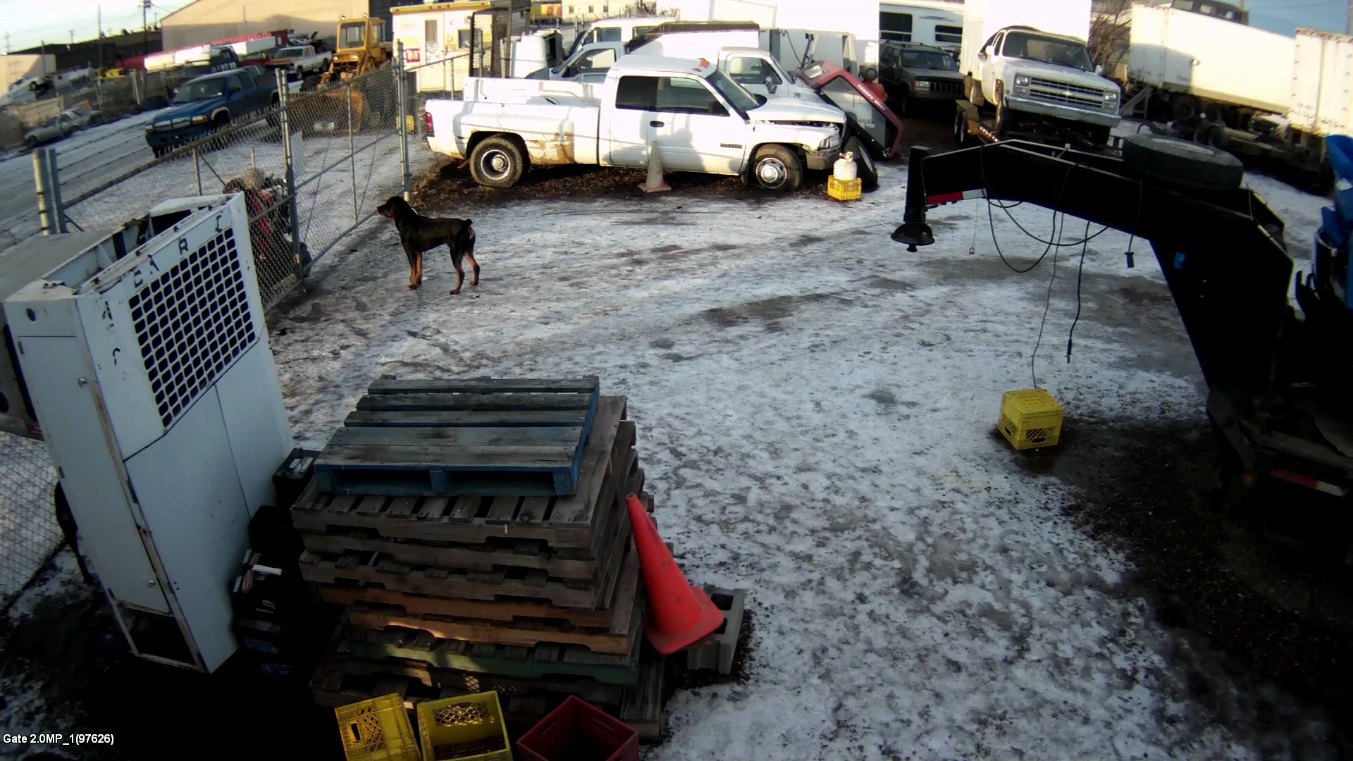

ak357 0 Posted January 7, 2012 So far for the £8k budget I have: 2 x 5mp domes - (5.0MP-HD-Dome-DN) - or similar compatible equivalent - both mounted outdoor. 4 x 3mp domes - (3.0MP-HD-Dome-DN) or similar compatible device. 1 for indoor, 3 for outdoor. 1 x 3mp camera - (3.0MP-HD-DN) or similar compatible device, for use in garage. 1 x Standard license for Avigilon Control Center (not enterprise) for 8 cameras. 8C-HD-NVMS-STD However, the internal dome may be 2mp (2.0MP-HD-H264-DC1) depending on whether it can cover the area I want. Room is 7m x 5m (23' x 16'5") with one external french door. garage is currently 5.7m x 5.6m (18'9" by 18'5) so this too could possibly be done by a 2mp camera, but would prefer the 3mp I think. In time this is going to be 14.5m x 6.5m (47'7" x 21'4") so will probably need an extra camera at the opposite end. (not included in the present budget) Keep in mind that all HD 3-5 MP domes cameras comes without lenses have you decide what you want for lenses ? I personally would just use H.264 comes with remote zoom and focus lens look at the coverage example Share this post Link to post Share on other sites

hardwired 0 Posted January 8, 2012 So far for the £8k budget I have: 2 x 5mp domes - (5.0MP-HD-Dome-DN) - or similar compatible equivalent - both mounted outdoor. 4 x 3mp domes - (3.0MP-HD-Dome-DN) or similar compatible device. 1 for indoor, 3 for outdoor. 1 x 3mp camera - (3.0MP-HD-DN) or similar compatible device, for use in garage. 1 x Standard license for Avigilon Control Center (not enterprise) for 8 cameras. 8C-HD-NVMS-STD However, the internal dome may be 2mp (2.0MP-HD-H264-DC1) depending on whether it can cover the area I want. Room is 7m x 5m (23' x 16'5") with one external french door. garage is currently 5.7m x 5.6m (18'9" by 18'5) so this too could possibly be done by a 2mp camera, but would prefer the 3mp I think. In time this is going to be 14.5m x 6.5m (47'7" x 21'4") so will probably need an extra camera at the opposite end. (not included in the present budget) Keep in mind that all HD 3-5 MP domes cameras comes without lenses have you decide what you want for lenses ? I personally would just use H.264 comes with remote zoom and focus lens look at the coverage example You are not helping encourage tourism to Canada with that picture.... I'll try to post some 2MP and 5MP Avigilon samples from a landfill I did recently, they are prettier! Share this post Link to post Share on other sites
hardwired 0 Posted January 8, 2012 Id go with the H264 indoors if the 2mp was enough for the living room - which I think it will be. However for the garage I would like as much detail as possible and I did not think that th H264 with auto lenses went above 2mp. The present garage installation calls for about a 4-5mm lense to cover the width of the garage at the distance of 5-6m. The 5mp externals would need 5mm lenses given the distance to target and scene width. Ive been using this calculator to come to those conclusions: http://www.plugnplaytechnologies.com/av/avigilon%20-%20the%20best%20evidence%20-%20%20camera%20resolution%20and%20lens%20estimator.htm Ideally Im looking to get around 75px/ft or at minimum 60px/ft. I know I cant cover the whole house at that resolution for the budget, but pinch points of entrances, out buildings & entances/exits to the property, and doors to the building along with two rooms internally should hopefully be possible. The installer will hopefully be able to advise on different lenses to cover the relevant areas, but hopefully Im not a million miles out. What do you think - is that equipment within budget or am I way out? The lenses are the one item I havent found any prior evidence of pricing on. Clearly if they are $1000 a piece then I may be out of luck, but I hope they aren't The Kowa varifocal's (great lenses, BTW) I've used with the 5MP box cam aren't cheap.. Not quite $1K (USD), but definitely not cheap. Share this post Link to post Share on other sites

ak357 0 Posted January 8, 2012 You are not helping encourage tourism to Canada with that picture.... I'll try to post some 2MP and 5MP Avigilon samples from a landfill I did recently, they are prettier! I was not trying to promote Canada by the way job was done by person having no clue I sold him product explain how and what to do He installed I setup Share this post Link to post Share on other sites
