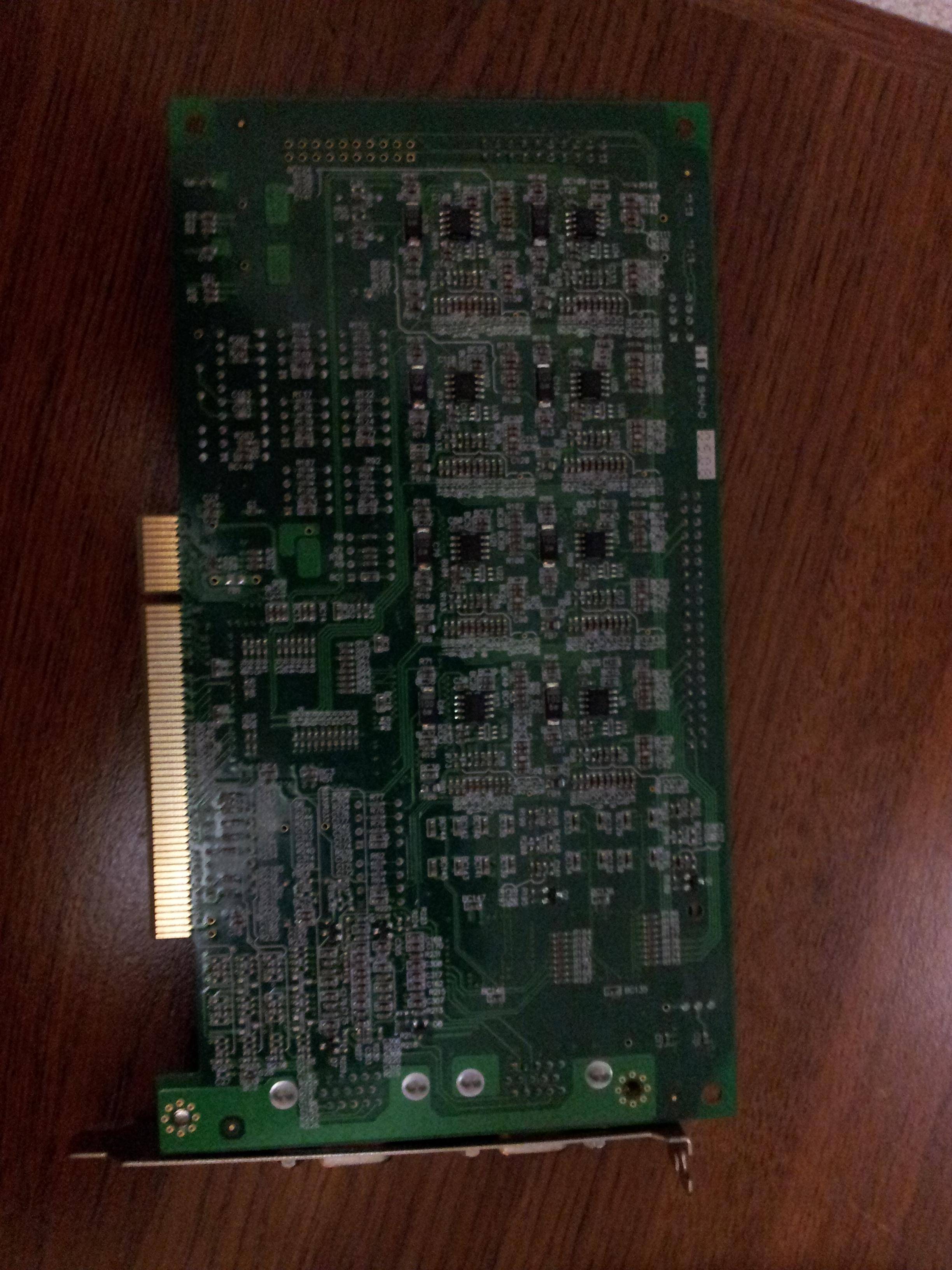

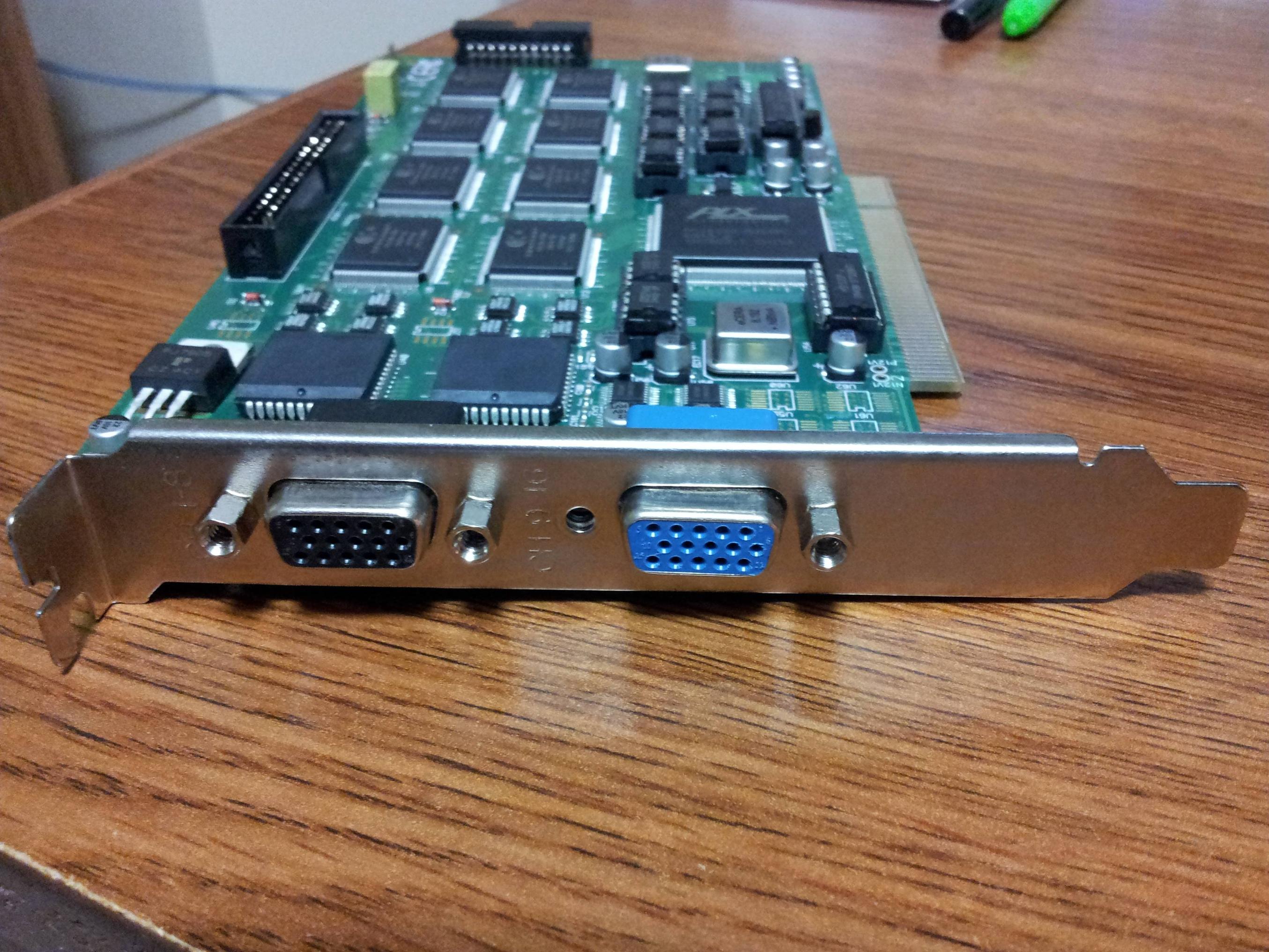

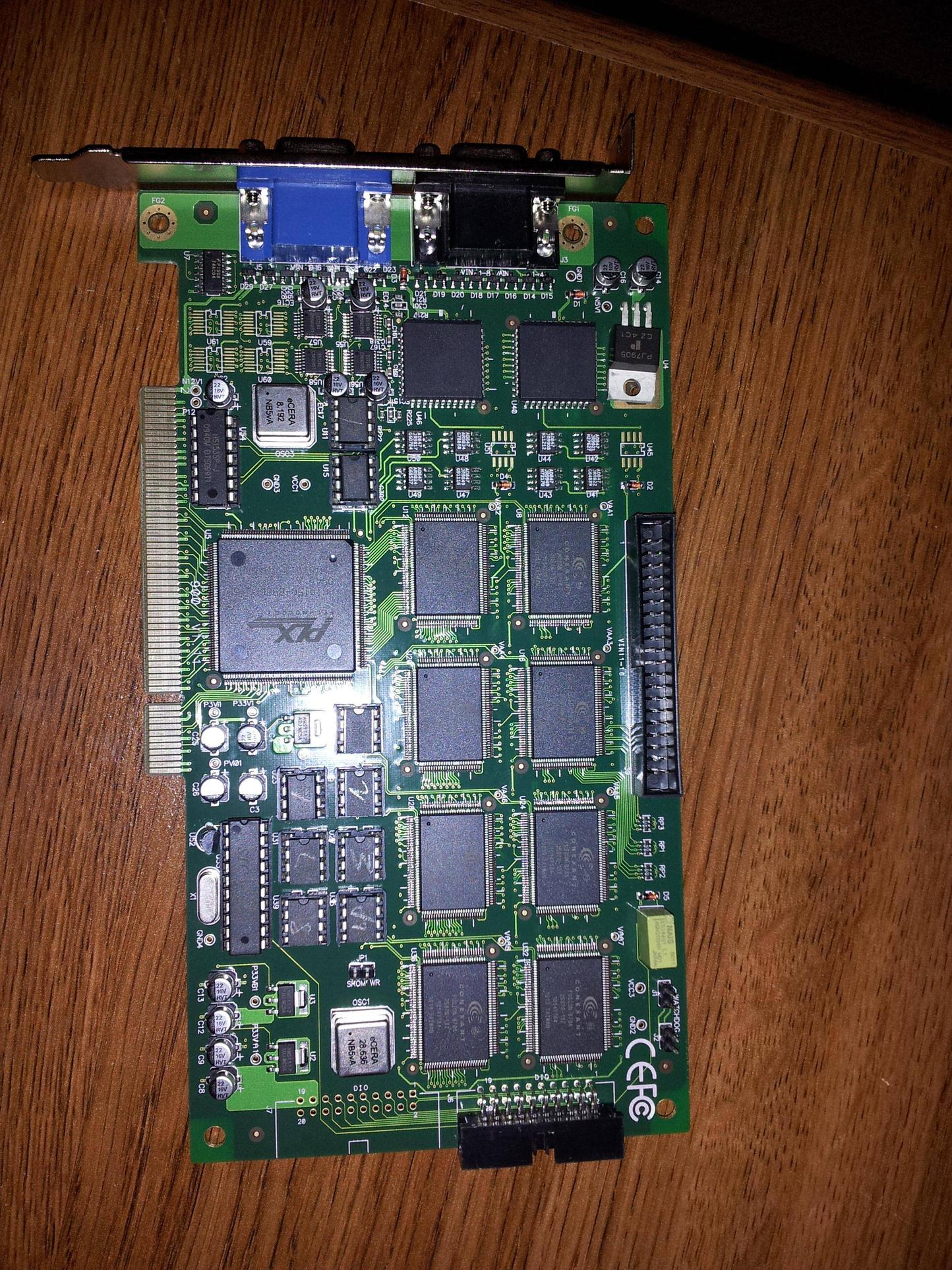

i am trying to help a friend get this card working.
quick story.
a friend of mine purchased a used PC from a friend of his for cheap...not sure the price, but he needed a 'shop' computer so something basic that could get online is all he needed.
i have done some work with GeoVision cards/DVRs and when i saw the back of the PC i spotted what i believe to be a legit GeoVision card.
of course the PC was given to him with every program uninstalled. i have to assume it wasnt a reformat because the D: drive had one folder in it...'history' which i have always know to be a GeoVision thing (maybe i am wrong...but didn't GeoVision name their storage folder history?).
all of my GeoVision cards have a sticker on them identyfing the hardware/card type, but this one doesnt have it.
these are the quick pictures i took, but i am not sure if they will help.
i have the 8.5 software and i tried installing 600, 600b, 800, 900, 1120, 1240 (the numbers might be a little off i am going from memory), etc....and when i launch the program i get the 'this card doesn't match with the software....' error.
could it be that this isnt a geovision card?
my buddy did put a call into the person who he bought it from, but all that person could confirm was that the cameras were working when the computer was disconnected (business closed down and the owner was selling parts)...
any help is appreciated.
i can try to take a pic of something specific if someone needs to see a more detailed image of a certain part of the board.
thanks.

Every GV card I've worked with has the Model name printed on the PCB, Except one old school gv250.
Thats the green PCB so its old, and its got no markings so that's either a clone, or really old like, you'll be lucky to run gv 8.11 old, your better off looking at version 7.xx software.
Another really easy identifier, is install the drivers first then go into your hardware page and see what your system recognises it as.
Gut feeling says its a clone, it doesn't look quite right to me.
