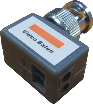

1) What type of balun will there be at the camera end to receive power & video?
Any type of balun will do - you don't NEED one with power pass-through. You can use regular screw-terminal or toolless baluns and just split out the ends of the Cat5e yourself - wire one pair to the balun, two other pairs to the power connector, and leave one pair as spare (I normally use blue for video, green and orange for power, and brown for a spare - no particular reason).
OR you can use the type with an RJ-45 connector on one end, and BNC and power leads on the other end.
It really is up to you as a matter of personal preference.

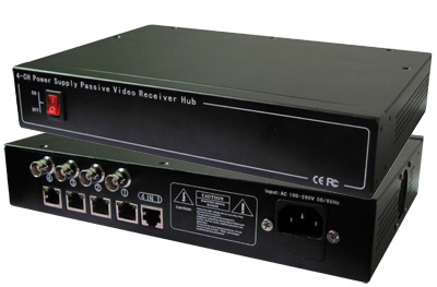

Then use something like this centralized in the garage - four baluns *and power* in one unit:
Plug each camera run into one of the jacks, 1 thru 4.
Then plug your run going back to the DVR into the "4 in 1" jack.
Repeat all this for the second garage.

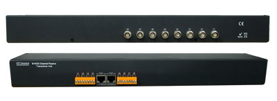

At the DVR, take your two runs from the two garages, and plug them into this:
Then run 8 short coax cables from that to the DVR.

for cat5 to each camera then you just need 2 of these one on camera and the other dvr. you can only use 1 Pair of your cat5 so the other pairs you use for power for the camera.
same for your PTZ except 1 pair for video and 1 pair for PTZ data
