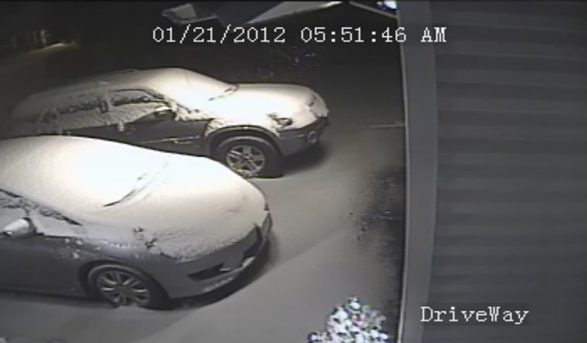

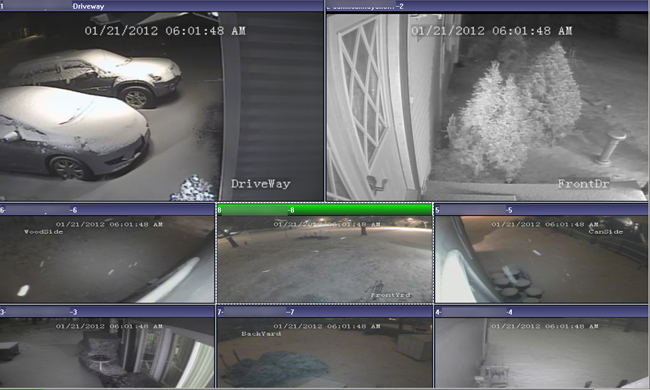

here is a sample of that camera .. light on, light off.
and this is what the location looks like with a Color IR camera with light off.

Well golly, I LOVE pics! Here's this mornings snow storm in the early stages, all with the equipment I've been talking about.

LOLOL! I knew you post something about like that Rory! This will end at about 5". I don't like the snow either my friend. AC...ya mofo!
Love the blue just before dawn in this shot.
Maybe I'll post some more later when it's deep. Gotta sleep before the dig out.
