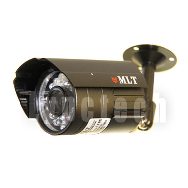

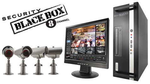

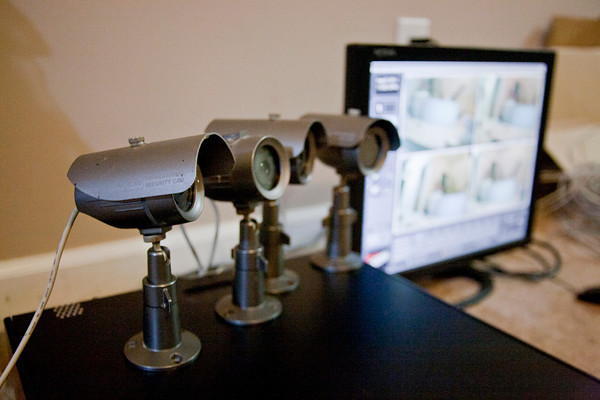

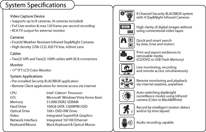

Firefighter 0 Posted January 26, 2012 Hello! I'm in Middle TN, I work for my city as a Full Time Firefighter. I'm also a Photographer. I'm blessed to have been able to purchase an older home with character inside our local Historical District Society. It being my first home also. I've lived there for about 8 months. I've always been into security. So I was lucky and came across a system and purchased it. It covers my Home (Main flr 2,600 sq ft. Not incl. full basement) My land is 7/10 of a full acre.... So it's not too small. Granite, It's (vid system) not super nice, But I think we can all agree something is better than nothing. Current Setup: Netrome Security BlackBox 8 Chan. 4 Camera It has already Payed off twice. Here is a screen shot of the front yard/porch So, As you can see it's the typical entry system. I like it, But being a technical detail nerd I burn for better and more. So, I have a couple choices. With a budget of about $600 (Includes selling old system) I can either build my own system, get the same basic cameras only have more... like 8. Get a better DVR and call it a day for now. But... What I Really Really want to do is go ahead and really upgrade. To a IP MP system. NIP 1MP Cameras... 720P HD resolution... Problem is it's not cheap. I can get the cameras for about $150 a pop... That's my $600 budget right there on cameras. Or, Buy two and a nice dvr for now and every few weeks purchase another camera.... I would like 8 1MP 720P Cameras total..... Depending on the dvr maybe add a few lower quality cameras to the system. So, That's my dilemma... Hello and glad to be here!! lol Share this post Link to post Share on other sites

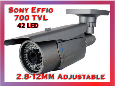

Firefighter 0 Posted January 28, 2012 No, My question is: If I buy 700 tvl cameras, Will I actually get 700tvl? Or would it be a waste of time, The link I provided says it doesnt matter. the camera may put out 700 tvl.... but ittl still be like 480 when it gets to the dvr... I'm selling my system and was going to buy these. http://www.ebay.com/itm/700TVL-Sony-Effio-Outdoor-42-IR-2-8mm-12mm-Focus-Zoom-IP66-Security-Camera-/140690774509?pt=LH_DefaultDomain_0&hash=item20c1d2d9ed Right now I have 420 tvl cameras. ( See top post ) Share this post Link to post Share on other sites
Soundy 1 Posted January 28, 2012 No, My question is: If I buy 700 tvl cameras, Will I actually get 700tvl?Or would it be a waste of time, The link I provided says it doesnt matter. the camera may put out 700 tvl.... but ittl still be like 480 when it gets to the dvr... It's not a "waste of time" necessarily, camera quality depends on a lot of factors besides just TVL. I normally use CNB cameras that list as 600TVL, but I spec them because they're a versatile design with good low-light response, not because of OR in spite of the TVL. http://www.ebay.com/itm/700TVL-Sony-Effio-Outdoor-42-IR-2-8mm-12mm-Focus-Zoom-IP66-Security-Camera-/140690774509?pt=LH_DefaultDomain_0&hash=item20c1d2d9ed Right now I have 420 tvl cameras. ( See top post ) They look like an "okay" camera for the price... nothing special, probably not much better or worse than what you have. There is the "weakest link" theory, of course, that your overall image resolution will only be as high as the highest part of the chain, so there's certainly no harm in having cameras that are higher resolution than the video standard supports. Share this post Link to post Share on other sites
Firefighter 0 Posted January 29, 2012 Ok thanks for the info. I'll have to double check, but I think they have a feature that I wanted. Which was, It darkens the bright areas, and lightens the dark areas. I have Big Shadow Issues at my house. So it would help alot to have that feature, Among others of course. But see, If its not worth it. I might as well pick up these $20 420tvl cameras and have a bunch of em vs the 4.... lol, I know this is all stuff that comes from a newbie. I just hate having such a low budget of 600.... Share this post Link to post Share on other sites
