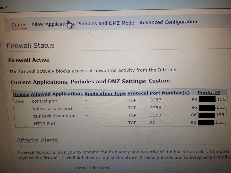

Here are some pics of my router config:
You can see how I have put the settings.
Maybe private NAT might be the problem??

The ports which I have allowed on my Hub on the picture above are the exact port settings on my DVR. My internet connection is setup as DHCP and my DVR is set as static IP, do you think that could be the problem?

The port settings on the DVR are exactly the same as above in the picture which I have allowed on my Router/Hub.
So I don't see what the problem is?
