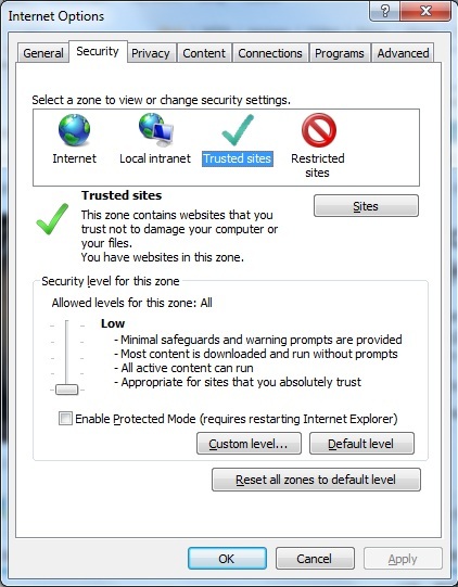

- Go in Internet Explorer > Tools > Internet Options > Security
- Uncheck the box ‘Enable Protected Mode’
- Restart you Internet Explorer
Now you can save the snapshots and video clips from the cams interface to your desktop or wherever (and they will be visible)

My enable protection mode is already unchecked.

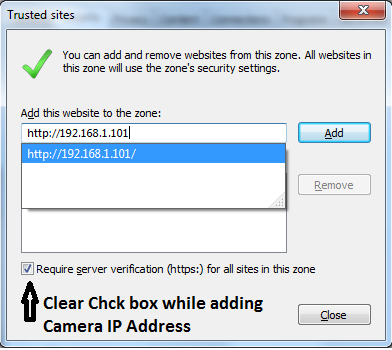

What I did is sort of what ssmith10pn suggested, added the cam IP address to local intranet (no other changes) and now I can see the save files in windows.
