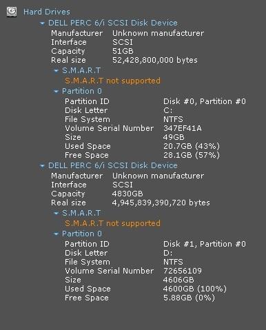

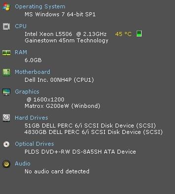

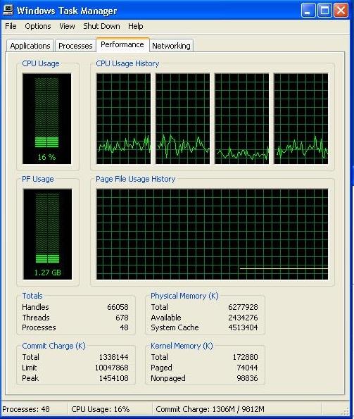

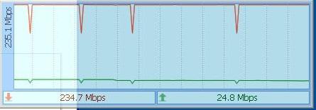

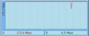

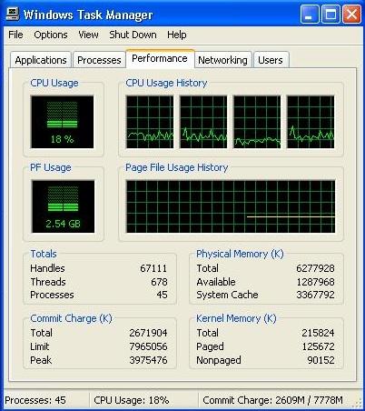

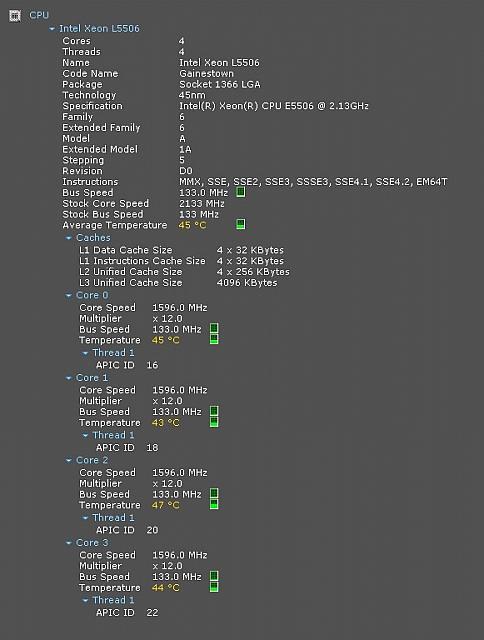

ssmith10pn 0 Posted May 25, 2012 A few I have running in the field. Share this post Link to post Share on other sites
CCTV6040 0 Posted May 25, 2012 A few I have running in the field. What software are you using if you do not mind me asking? Also is this only recording but live video is disabled? Share this post Link to post Share on other sites
ssmith10pn 0 Posted May 25, 2012 Live video is the upstream out to the Clients. It's Avigilon. The magic number on these boxes is supposed to be 250Mbps upstream and downstream combined. Share this post Link to post Share on other sites
thewireguys 2 Posted May 25, 2012 256Mbps downstream only Share this post Link to post Share on other sites
ssmith10pn 0 Posted May 25, 2012 I didn't know that. So I can put some more load on it then Share this post Link to post Share on other sites

ssmith10pn 0 Posted May 25, 2012 Hardware on the screen shots above. Share this post Link to post Share on other sites

ssmith10pn 0 Posted May 26, 2012 Live video is the upstream out to the Clients. It's Avigilon. The magic number on these boxes is supposed to be 250Mbps upstream and downstream combined. how many cameras do you have connected to this box? I can give you the numbers but does it really matter? It's not going to make it any clearer because there is such a mixture of cameras. (5) 1.0mp Jpeg2000 (17) 1.0MP H264 (2) 2.0MP Jpeg2000 (5) 2.0MP H264 (6) 5.0MP Jpeg2000 (12) 4 channel encoders Jpeg2000 15TB of storage Running about 35 days of stored video Server #2 has (19) 5MP Jpeg2000 10TB storage Server #3 (4) 4 port encoders Jpeg2000 (2) 5MP Jpeg2000 (6) 2.0MP H264 (11) 1.0MP H264 15TB storage running at about 50% There are about 7 more servers but they are about the same loads. Share this post Link to post Share on other sites
