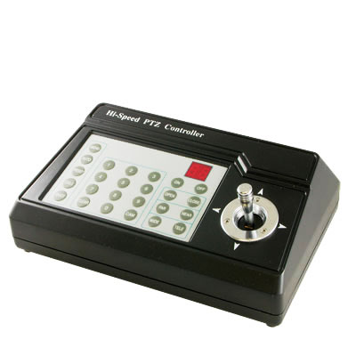

i do wonder about ptz controllers and their dedicated buttons,
i have a couple of 'hi-speed ptz controller' units,
very simple things, 2d proportional joystick, the usual set of 3 buttons for zoom, focus and iris, numbers to select the camera's etc,
then 'menu' 'auto' 'preset' 'call' 'shot' buttons, but my sunkwang camera's don't seem to respond to the menu or auto buttons,
i get into the osd using preset 95, but i do wonder if a different protocol would enable the dedicated buttons.
