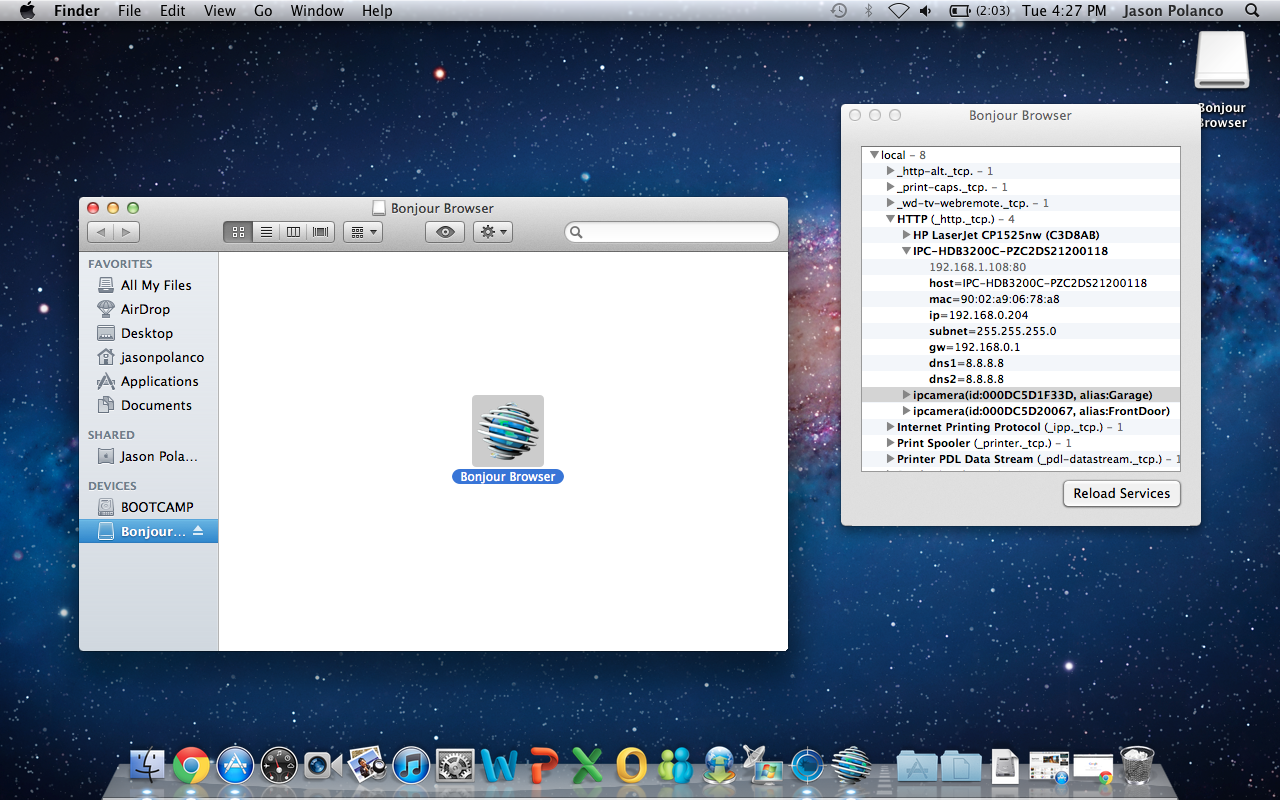

As for both Dome's I truly think there's a firmware bug with these cameras... both DOME cameras are set to static IP's; 192.168.1.108 from the manufacture. When both are connected to the POE Switch simultaneously, both will not display in the CONFIG TOOL software (assuming because of the IP conflict). I managed to use Bonjour Browser in OSX to display the cameras even with both assigned to 192.168.1.108... I attempted to do the same as I did with the bullets - change them to DHCP and reconnect them back to my network.
Here is where the "bug" is... See screenshot below - Bonjour shows the camera right below it it list the IP: 192.168.1.108 but if you look further down, it shows IP, SUBNET, and Gateway all within my current networks range. The cameras are receiving the routers DHCP assignment, but isn't assigning them properly... My next step is to manually add the mac address of each dome to my router with static ip assigned. so HOPEFULLY, that will force the camera to take an IP in my range as oppose to the default.
