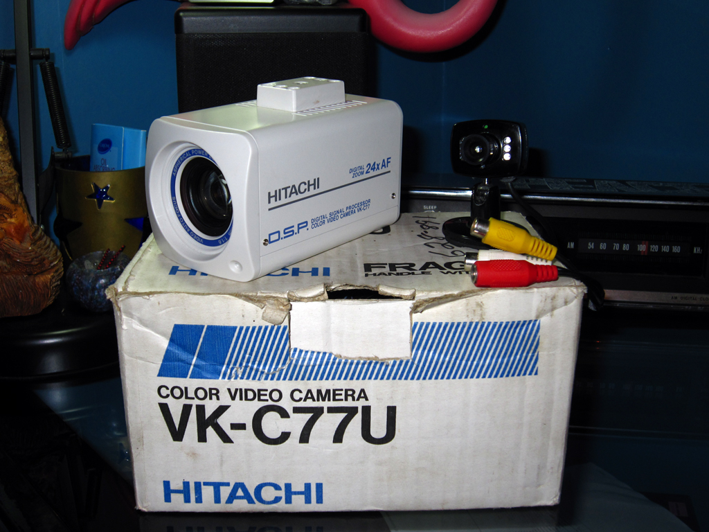

The white Hitachi VK-C77U retailed for $399? The small cam is a cheap B&W Swann Secura Cam SW214-SCC:
I am really impressed with the Hitachi's quality, and its auto focus. I think I'll be using the Svideo interface, it is highly configurable even via remote:

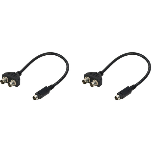

You should be able to run three RG59 cables with BNC connectors at each end, and use two of them with adapters like in this photo to change from the two cables to the S-video connector, and then use the third one for the composite input on the VCR. (Google Datavideo CB-2 for an example).200001_1.jpg
If you use bulk cable and put the BNC connectors on yourself, the whole thing shouldn't cost more than $40 or so.

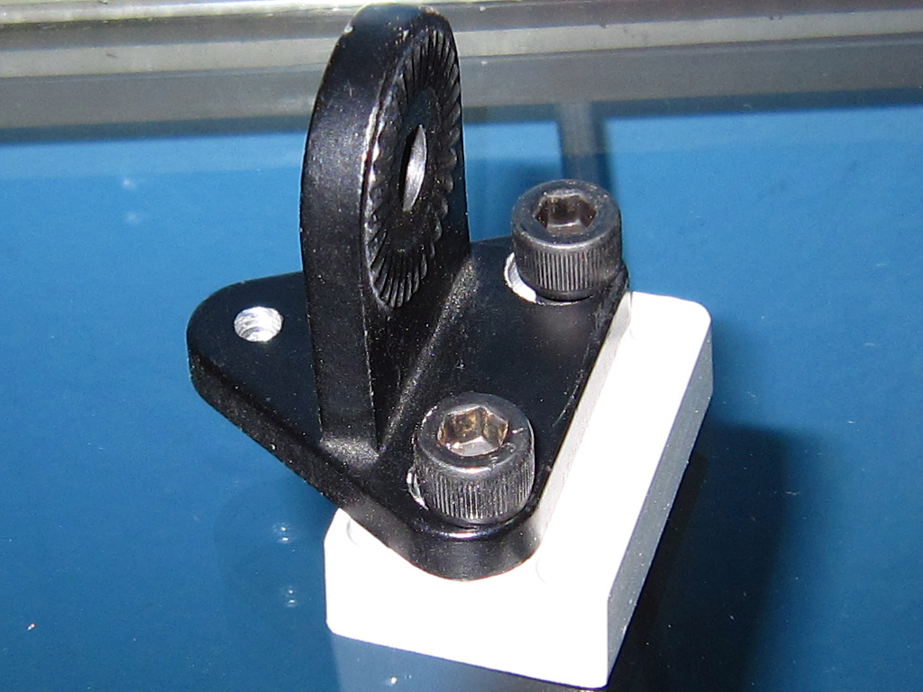

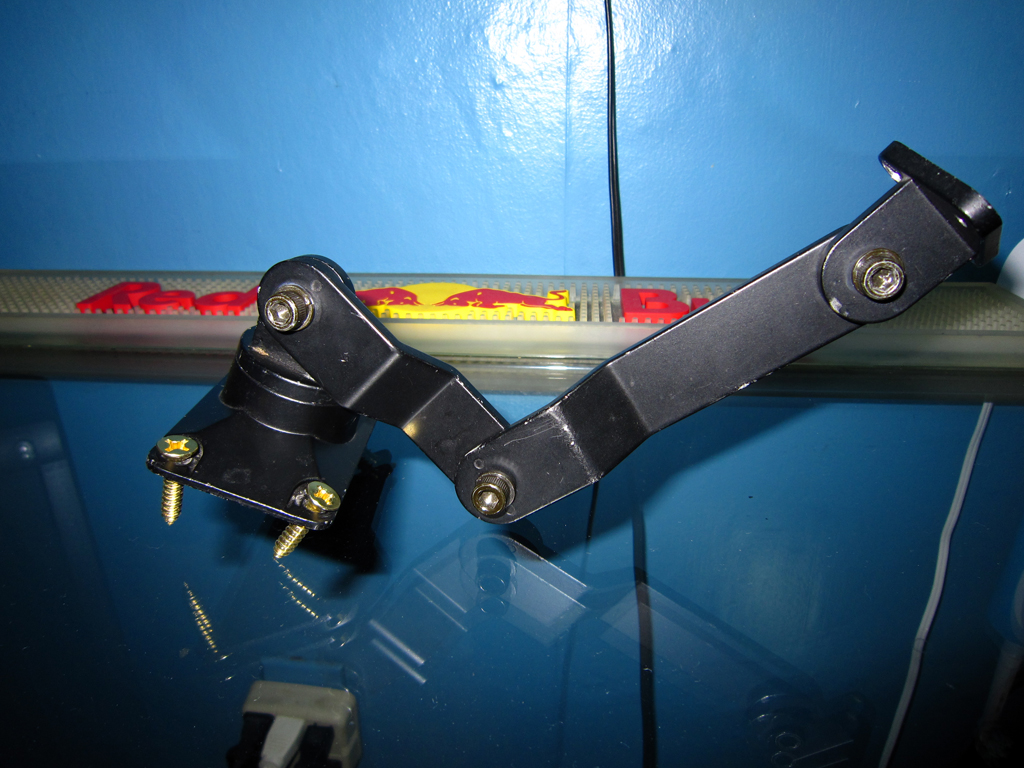

I found an old bracket in one of my parts bins, used for I don't even know what but I don't need the middle extensions:

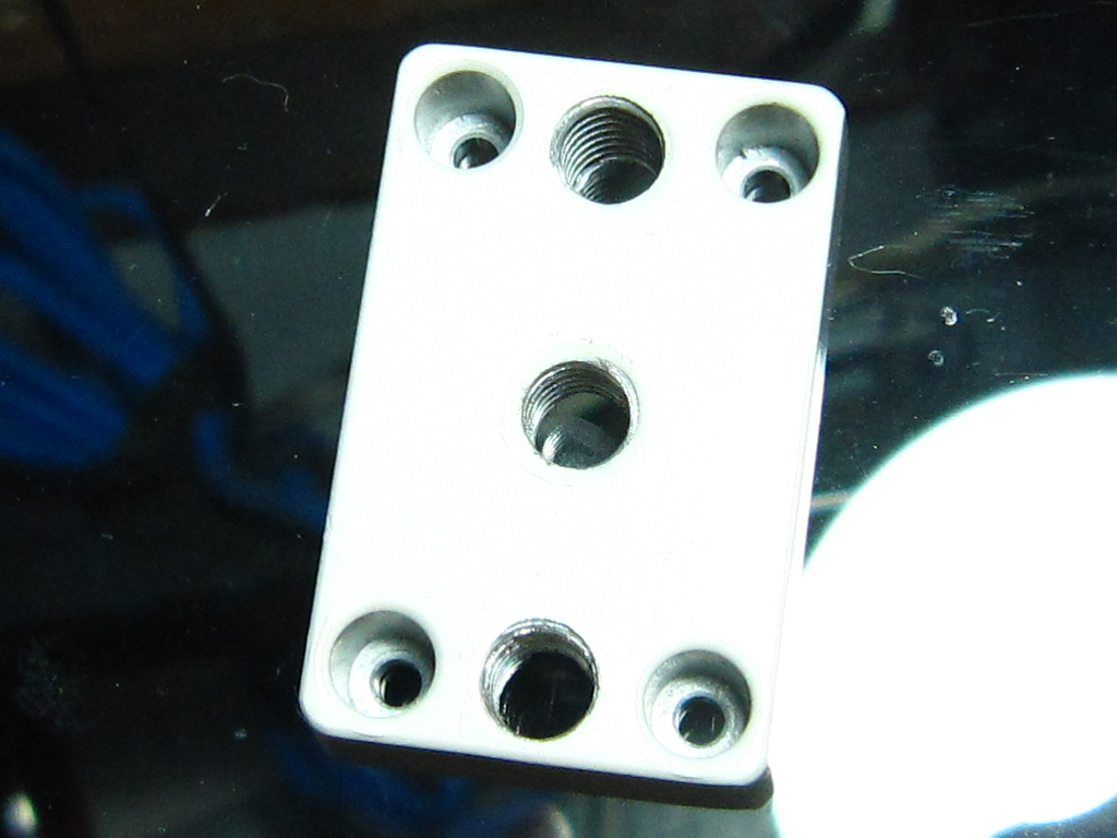

Only the middle and top holes were tapped on the camera mounting block so I drilled out the bottom and tapped it 1/4"-20:

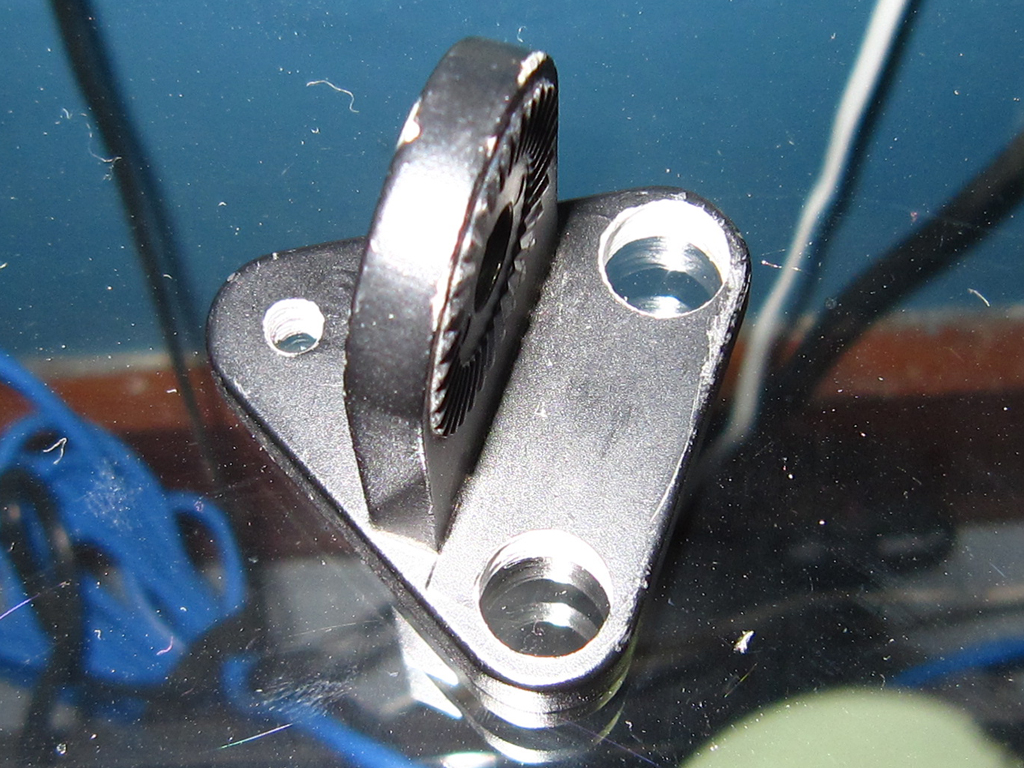

Like I said not sure what the bracket was used for but I drilled 2 of the end holes out:
Solid anchoring system:

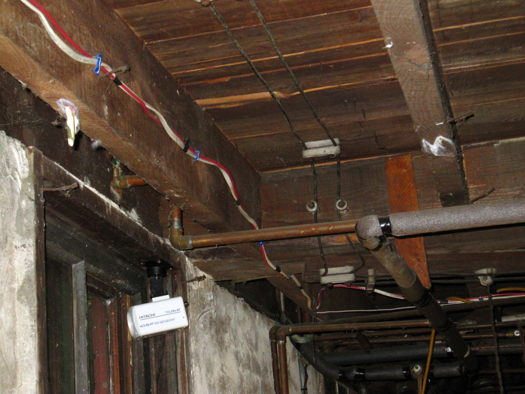

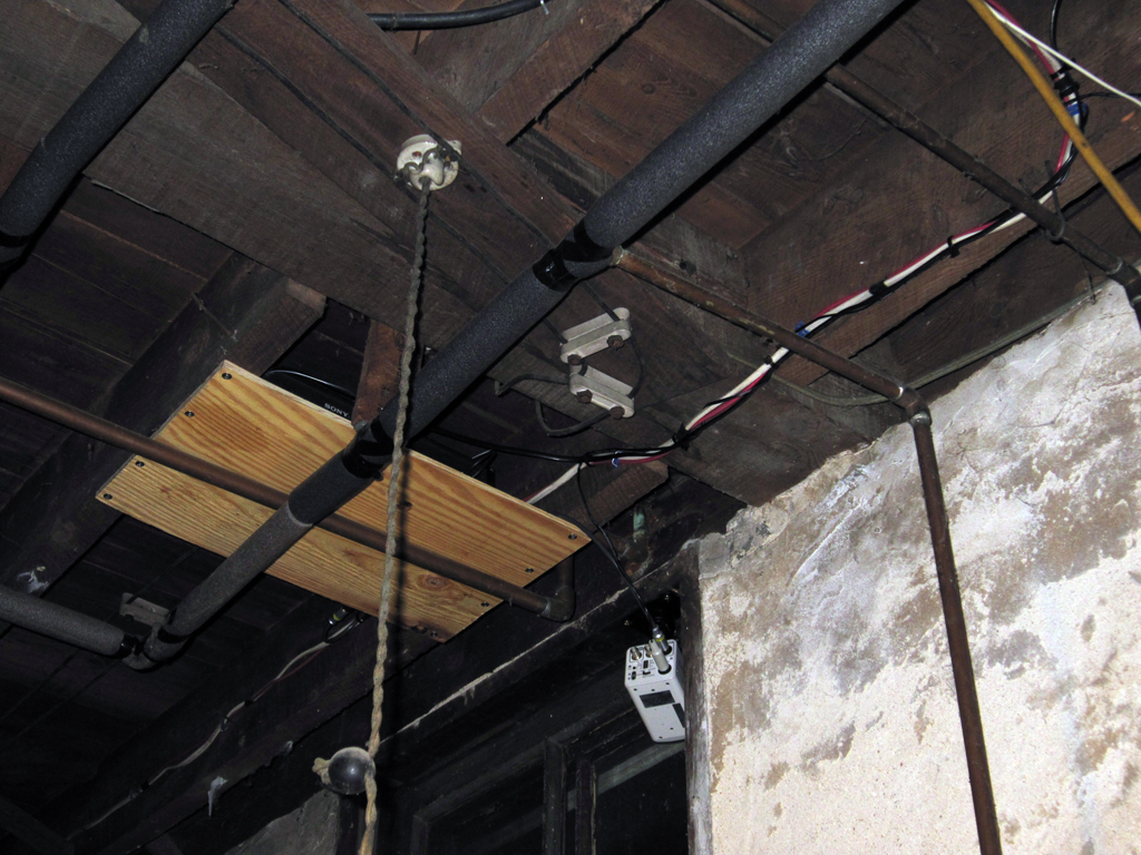

Mounted it right where I was talking about, I have an old creepy basement. If you look closely you can see I knocked out the inner pane in front of the camera to reduce focus problems since they are both wavy led glass, I'm also going to put a piece of plywood across the bottom of the floor beams to hold the VCR up the ceiling temporarily until I run cables two floors up which by then I may have a DVR upstairs:

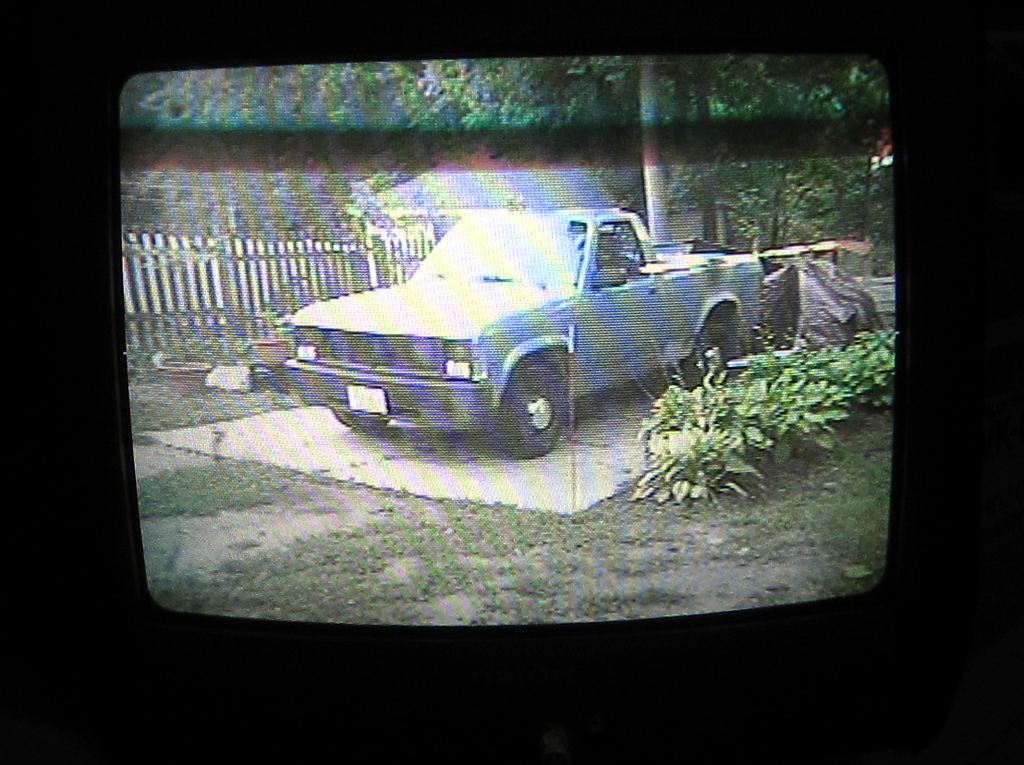

Just for framing purposes I used a 13" tube TV with an S-video to composite adapter...looks good I was worried it might not have a wide enough angle lens, it even covers my ATV tarped behind my truck. I can actually screw on other lenses if need be I'm going to look for a cheap wide angle lens:

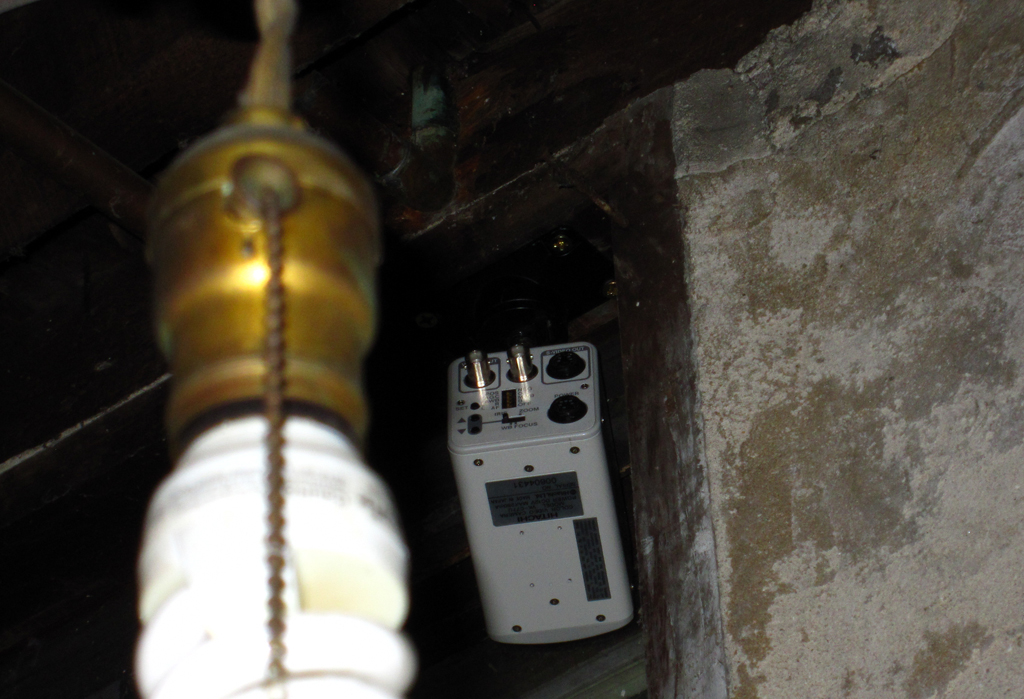

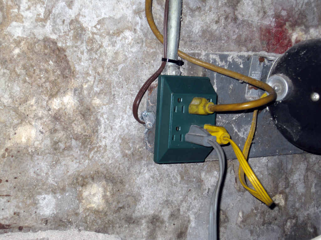

Worked on the system some more today, I cut the end off an extension cord and hardwired it to the junction box by the window:
I'm working with the cables and adapters I have on hand, to try an avoid interference I used a double male end (gold plated) composite adapter instead of a short patch cable. I realized I gave away my S-video VCR so I'm stuck with a Sony SLV-N51 which only has composite so I used an S-video to composite adapter (gold plated) and a gold plated S-video cable. In the background you can see a long stretch of mono composite video cable, it's not gold plated but will serve as a pull out connection to frame up the camera if needed with an external TV/display:
Like I said the VCR is temporary, it has gold plated composite inputs but the gold plated is only the front L2 inputs. It's a decent VCR; 19-micron heads. I like the fact you can rewind a T-120 tape in just 60 seconds with the Flash Rewind feature, good for re-recording/dumping a tape. Thing is that's a 6ft S-video cable, I don't need all that so it's curled up to the left of the VCR...but up against a wall voltage power line I hope it does not pickup interference:
