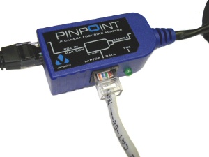

I am wondering if anyone has done this or knows of someone who can. For installing traditional analog cams I have an Ideal brand test monitor... extremely useful for aim/focus right at the cameras etc. I am wanting to figure out a way to direct plugin to an IP camera with my Samsung Galaxy Nexus smartphone... instead of lugging my laptop up and down a ladder.
It seems that this should be feasible...whether or not is possible...IDK
I have bought a few items to try out

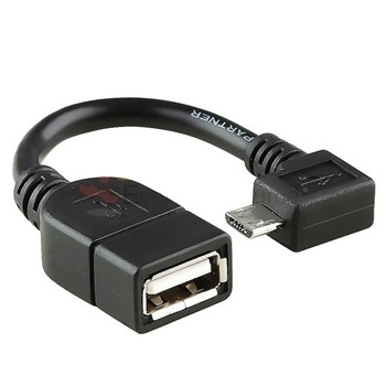

USB OTG
USB to LAN adapter
Pinpoint IP camera focusing adapter
I haven't received all of the parts yet but plan on tinkering... has anybody heard of such a thing? I've done searches on the internet for it and all I get is the traditional apps that assume that the cameras are installed on internet network.... but what about right at the camera

keep in mind for your idea to work, your phone would need drivers for the usb/nic... or more to the point, the usb nic would have to have some sort of android support, which i'm betting it doesn't.
