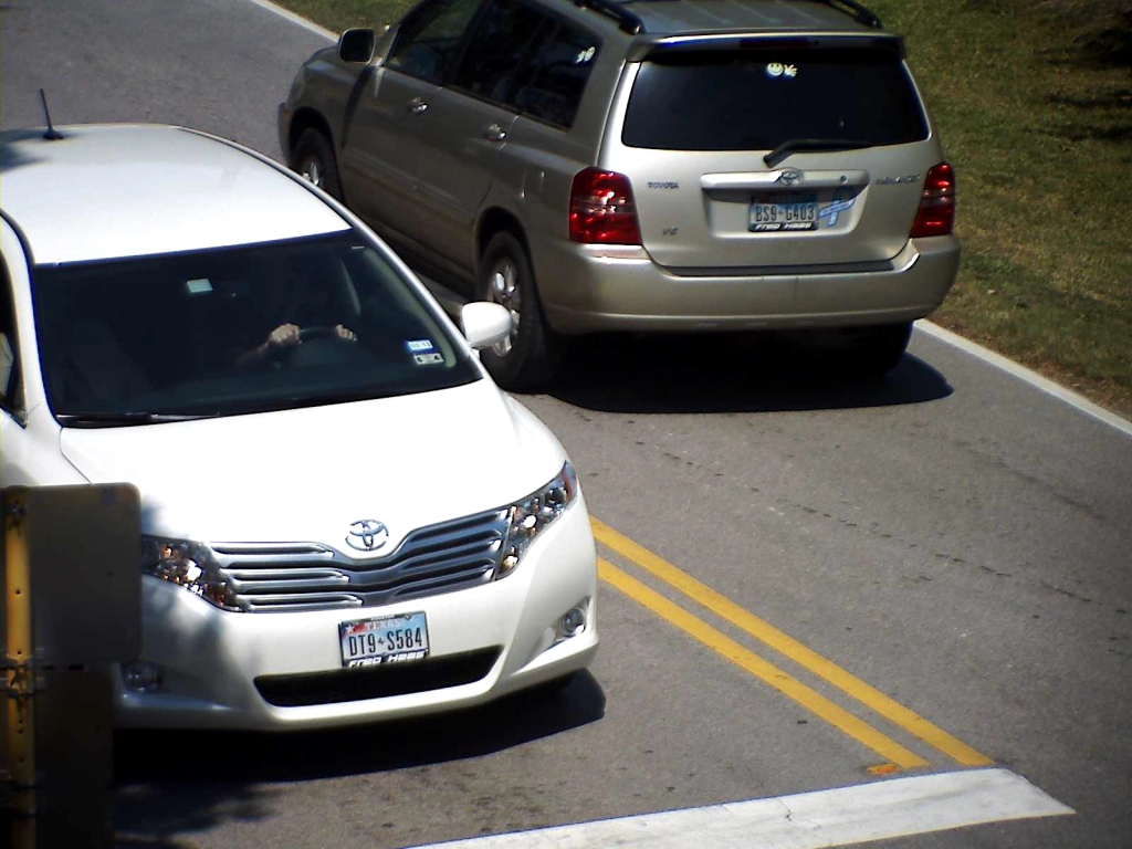

Day images are very good.

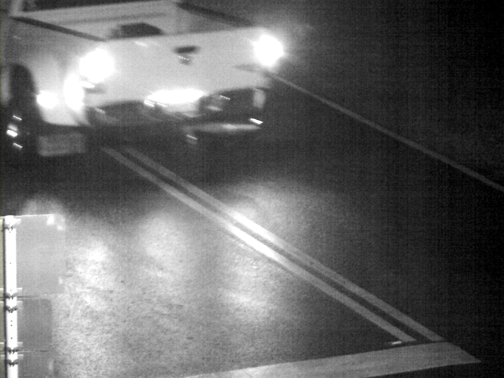

Typical night image.

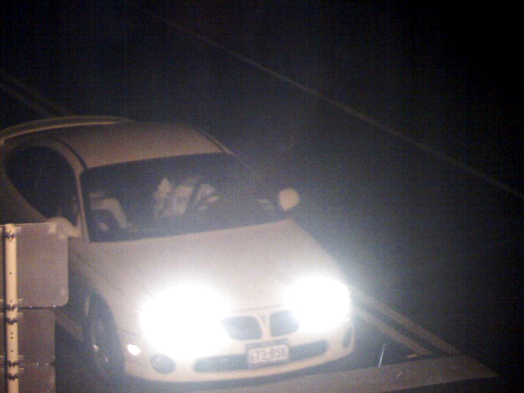

Sometimes we can get a shot a good as this but it is the exception.

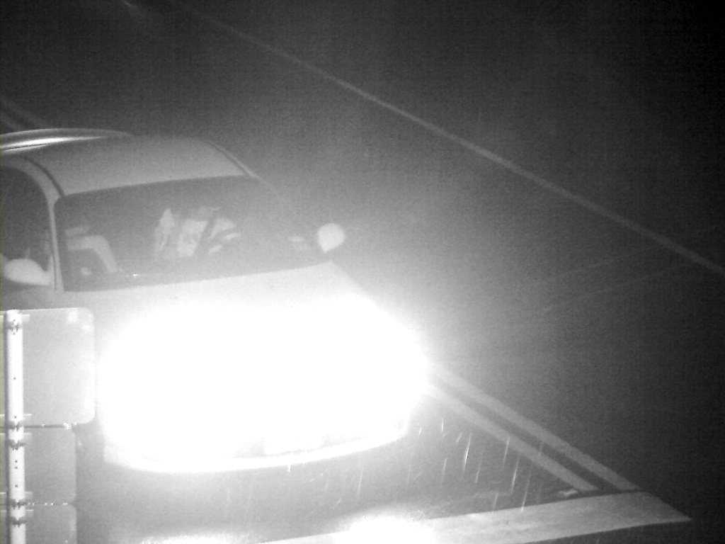

Vehicle leaving images are a problem.
Some people use IR pass (white light blocking) filters as well. This helps avoid the washout due to the headlights, though the high shutter speed can be very effective at that once you get the settings tweaked.
Hello
As I know most IP camera supplier is headach for LP capture for highlight bouncing at night time. Maybe you could consider carry out Vivotek or Axis which released some good stuff in deployed SONY exmore Sensor and P-IRIS lens which is excellent at day and night time.
