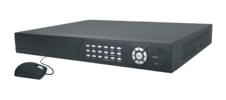

I got this dvr second handed in a local auction , i thought is gonna be easy to search and find a way to reset the password , but i am stuck with it , could u help me to reset the password , i believe it's from a company named higheasy ( i saw the name in page source of web client login form ) , and here is it's picture
Please do you know a way to reset the password

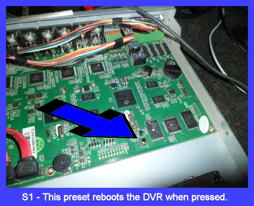

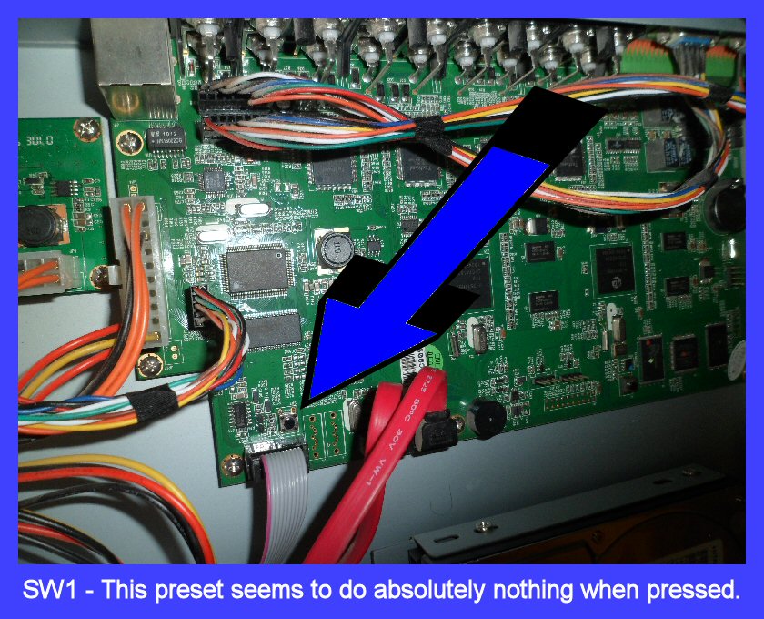

Their are two presets on the board, One is marked as S1 and the other is SW1.
SW1 doesn't seem to do anything and S1 reboots the machine, I've tried taking the CMOS battery out and then pressed and held S1 for about a minute or so while the machine is on but still no joy.

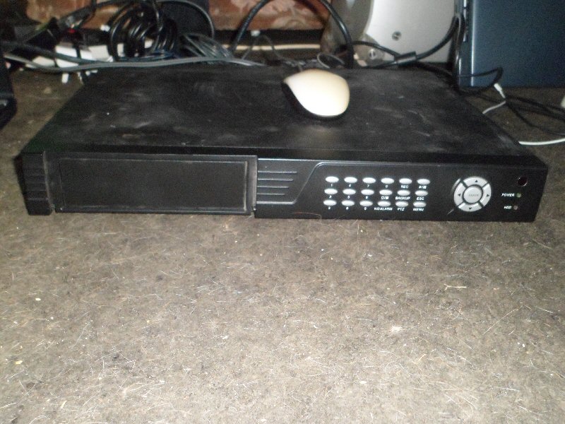

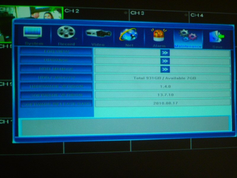

Just thought I'd add some pics with descriptions.
This is the DVR in question:

This is a picture of the Device Info:
This is a picture of the preset switch s1 which reboots the DVR when pressed:
and finally. This is a picture of the preset switch SW1 which appears to do absolutely nothing.
