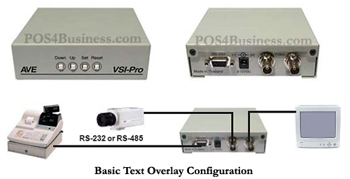

locat2mcctv 0 Posted January 21, 2013 I can vouch that the geovision pos works well when everything is setup, sometimes setting it up can be a pain. I have had some customer who use AVE VSI-PRO and it seems to be more user friendly when it comes to setup. AVE VSI PRO connects between the camera and all the configuration is in the box. From what i understand is you can give the model number of your POS system to AVE and they will pre program it that system prior to sending it out. Hope that helps. Share this post Link to post Share on other sites
bongofury 0 Posted January 27, 2013 Works fine with sps2000. But you will have to use a serial port. Ave vsi or Gvi POS box are not required, unless driving more than 75 feet. Select Star TSP200 journal printer and real-time print on SPS2000 Generic printer on Geovision. Share this post Link to post Share on other sites
