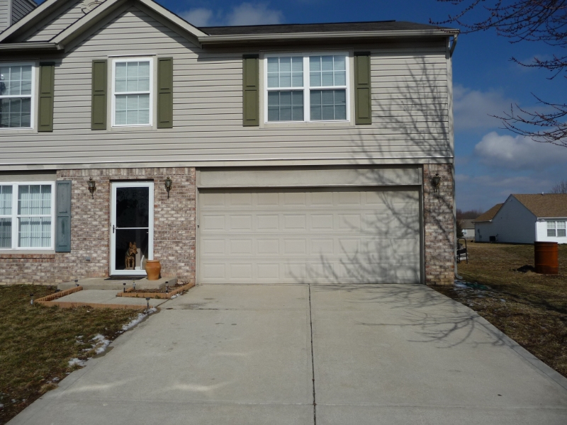

I'd stick a dome just over each man-door with maybe a 3.6mm lens. Something over the garage door with a varifocal going to at least 9mm so you can find the balance of zoom and field of view you want for closeups of vehicles, plates, and faces. Pick a dome or their big bullet, but a 6mm or 8mm fixed lens would be a decent all-around choice at a lower price point. I'd lower the zoom and widen the FOV of the garage cam if the front door cam wasn't angled towards the driveway a bit, but that'll leave a bit of a blind spot facing your neighbour to the west. I'd have a cam on both sides of the house and probably facing backwards from the corner nearer the front to catch people trying to get in the side windows. Depending on where your rear door is, the cam for that door might be close enough to be useful to ID someone going into your shed, but if you keep an ATV or whatever in there it might not hurt to have something zoomed in on the shed for facial ID. I like having a good view of my kids and wildlife in my back yard as well, so figure that into your plans if you think the kids might be playing in the vacant lot and your side camera is angled back to include the windows and siding of folks breaking in through your windows. A 90 degree lens gives good coverage but won't identify much at a distance, especially at night. Printing out a picture of your lot and putting a protractor on the possible cam mounting points after looking up the FOV angles from the specs of your various cameras will give a good idea of where and what you'll need. There are software tools out there too if you want to get fancy. Here's a free one-

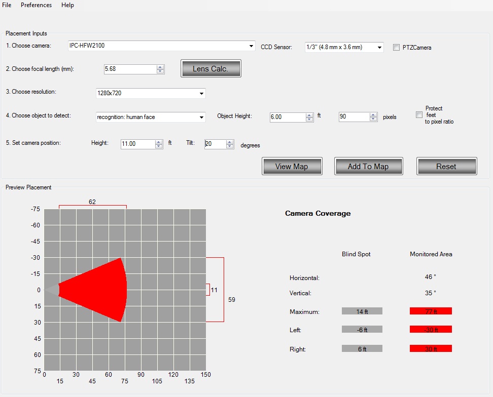

http://www.pelco.com/sites/global/en/sales-and-support/downloads-and-tools/tools/pelco-camera-tool.page
Facial recognition distances for camera placement are quite short though you'll be able to tell things like "thin white male in dark t-shirt and light pants with a hat" at a lot longer distances. I wish the tool had a license plate recognition distance option, but that's an inexact science anyway.

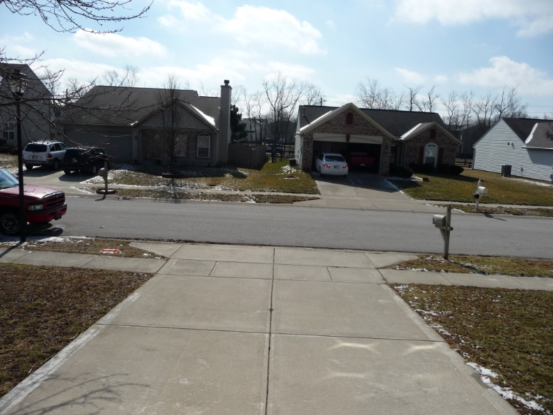

That HDB-3200C is a pretty lousy night-time camera but you can order it with a 6 or 8mm lens (no adjustment though- order it and hope you got it right). The HDBW-3200 or HDB-3200 (make sure there's no C) are much better at night and are varifocal (adjustable zoom). The 3200C might be all right for folks who come up to a door with a light on all the time but not good for outside of the bright light pool. Definitely wouldn't stick a 3200C in my driveway hoping to ID night prowlers. The $299/pair cams (you must be talking about the Costco ones, right?) come with 6mm lenses. Good for some things but have a pretty narrow field of view. Stick their specs in the Pelco tool and check out the field of view. Not great. 3.6 is pretty narrow for getting a big picture. Something even smaller (2.8 maybe) isn't bad for a doorway camera. Good enough for faces of those who reach the door but still gives a good idea of what's going on in the yard. You'll need something with lots of zoom for IDing folks touching a truck on the street. Varifocal up to 12mm with 2 or 3mp would be a good option.
ok..My house is 38" wide and my driveway is 43' to the street. according the the pelco tool, I would need about a 6mm lens on a 1/3" sensor. I used the IPC-HFW2100 as an example for my driveway cam. I am not sure this little camera would even be a possibility but it looks pretty good on paper.
Here is a view from the street up my drive
Here is the view holding the camera just above the garage door as high as I could reach.

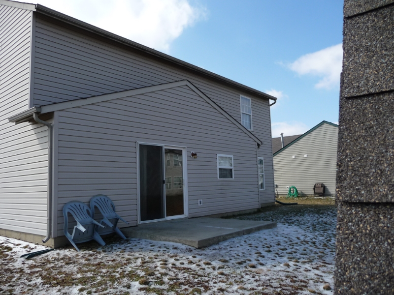

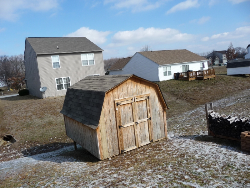

From the back of my house to the barn its 21' Here is a view from the barn:
I have a couple of different mounting locations in the back I would consider.

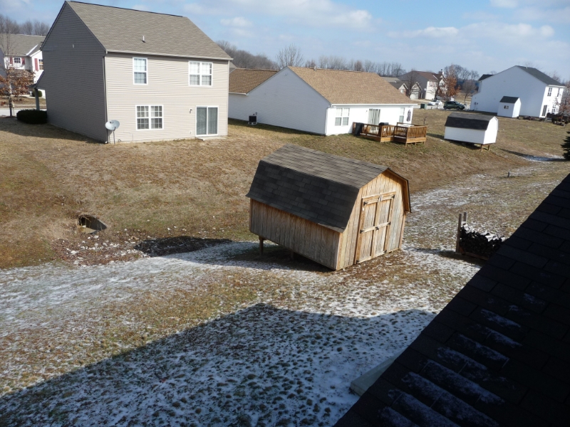

One right about the door. (held camera about the door and took a picture)
The other option is to mount it on the far corner of the house opposite of the barn. ( I held the camera out the the window closest to the corner of the house to simulate the view.)

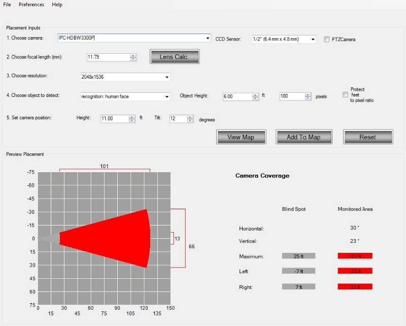

Here is what I entered into the tool for the IPC-HDBW3300P. Maybe I could put it on the front western most corner of my house looking across my front yard over to my driveway

Just for scale, here's a pic of my Escape that I backed out to roughly 43 feet (paced it to the plates) in the driveway. 1.3mp Axis P3364VE (1280x960) with varifocal zoomed out to the maximum of 6mm. Lighting is from a streetlight on the pole you can see plus two not very bright fixtures 40 feet away and 15 ft up on the soffit above my veranda. Plates are easily readable with lights on and off at night. Faces aren't very good at that distance at night either in colour or with IR. The pic IS modified a bit. I dropped the jpg quality a bit to keep it under the 250KB filesize limit and I erased the first three digits of the plate.
43feet_1.3mp_night_colour_lowerquality.thumb.jpg.f8af0371200c6001ef4eed3c4f22b8f6.jpg
Oh, just thought I'd explain the tool a bit better. On the 1.3mp 2100 bullet specs that you plugged in, facial recognition (a really good facial ID) is good only to the grey area on the cone, not the red area. That's about 15 feet. The details in the 3300 bullet show a really good facial ID out to about 25 feet. You can stretch those distances and get a decent ID but the exact details get fuzzier as you get farther away, especially at night.
Ah.. I did not know that. Ok.. that explains a lot. I might be able to squeeze a few more feet of facial recognition out of the 3mp if I change the angle a bit but it is probably the minimum I'd go. I'd probably have to go with a good zoom for that front west corner for the red truck as suggested. Probably bot a dome for that one.

If it were my place, I'd stick the front door cam just above the top of the door on the side away from the garage door. A white bullet cam would stick out on the brick though, so maybe up higher at the bottom of the siding. A dome would fit in better down lower though, plus leaves folks guessing a bit as to which way the camera is pointing. You don't want your blind spots too obvious. Play with placement a bit before drilling and running wires. You don't want to rush things and mount it too high and just see bald spots, hoodies, and hat brims. Have someone wearing a hoodie and a hat walk up to your front door (not stop, pose, and look up) to see what I mean. Most people will walk with their head down watching where to place their feet when outside. One cam probably to the corner (right side looking at it) side of the garage door for a straight on pic of plates, but it won't be toooo much better than the front door cam (they'll overlap coverage of the driveway) until you get one with a longer lens. Rear door one to the side away from the shed crossing over to look at the shed for double duty. Then another one probably to the shed side of that door looking crossed away from the shed to cover the rest of the approach to your back windows and door. Then, with the extra pair, maybe the first one on the side of the house at the front corner away from the garage (left corner looking IN the front door) pointing towards the road. After that pick where you want the last one based on personal preference and where you want covered. Clear as mud yet?

6mm for the drive should be ok for anything pulling into your driveway but would be too short for IDing folks touching your truck on the street for my tastes. I've never seen a good pic of plates at night from a Dahua (especially against headlights) so that might be bit of a long shot, but daytime should be easy. I'm not saying a Dahua can't grab plates at night with some tweaking but I haven't seen any shots showing it though. That's one of the reasons I went with an Axis for my driveway cam. Easy plates day or night.

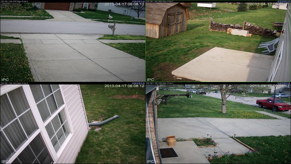

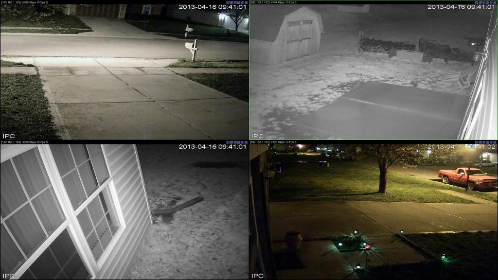

Here is a night time screen cap of the 4 cams I have installed so far. I will probably move them around when I get additional cams.
If anyone has a good source for dahua 2.0mp cams let me know. I might get some on eBay..
Also as you can see my driveway has decent light from the light post. I was thinking about getting one of those 1080P non ir domes if this would be enough light?
