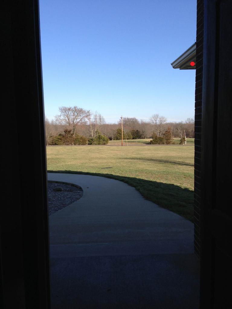

This is a shot looking out the front door, and as you can see, only the very end of the soffit is visible from where I am standing inside. In this picture, the red dot indicates the bullet cam pointing back towards me and the door.

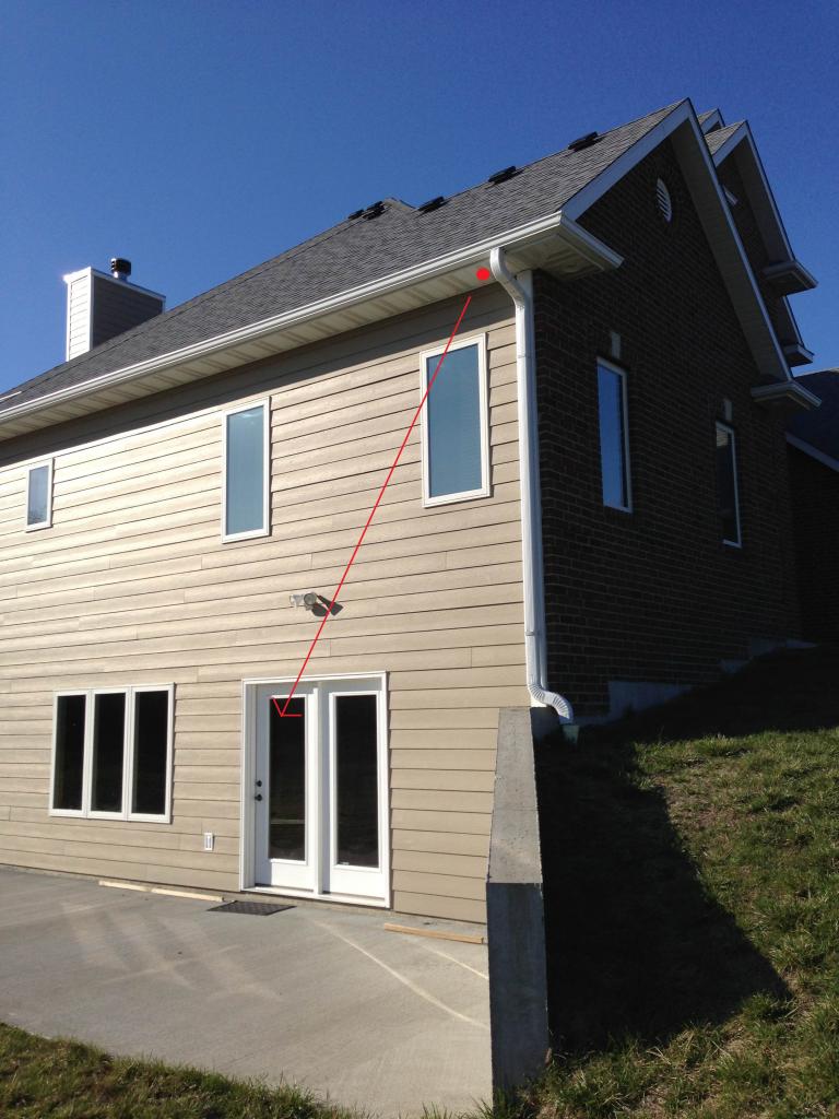

Next picture is of the basement entry. Its self explanatory. Is this a good location?

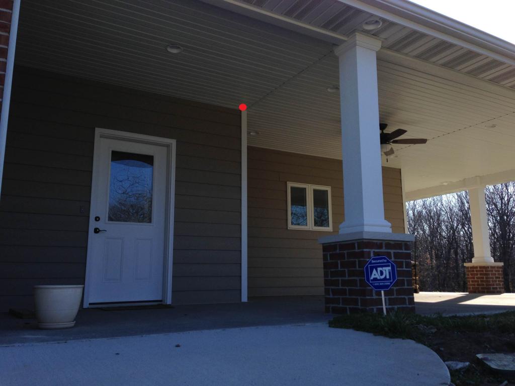

We have an L shaped covered porch with two entry doors. The first one is here:

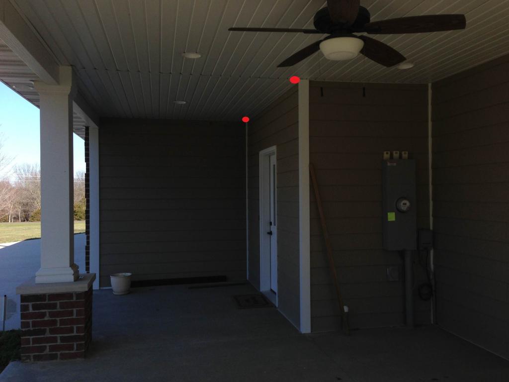

The second door on the covered porch is tricky for me. Do I put it in the corner, or do I hold it out so I can also capture that side of the driveway as well? You will see two red dots to indicate my dilemma.

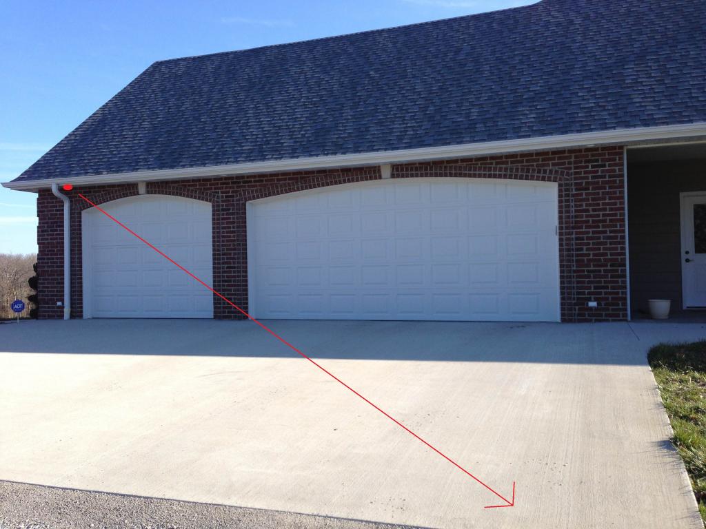

Finally, a shot of the garage doors, which Im hoping to monitor with a single bullet cam in the soffit as represented by the red dot and arrow. Will this suffice?
I can change out the lenses on the bullets if needed, but all come with the 3.6mm. I will be adding a couple of additional cameras higher up for a property view, but thats down the road a ways. Any and all advice will be much appreciated.

For the front door I'd place the camera looking outwards from the front door. Much more useful because it gets a better front-on face shot of those approaching, plus a good view of the front yard and what is going on, who is coming, etc. That's the best use of my front door cam with a monitor at the front door. Any outdoor rated camera that dies from looking in the general direction of morning sun is defective, IMHO.
The basement entry red dot is too high for good ID much of the time. Anybody coming to the rear door will be quite far away when the cam has a reasonably flat angle at their face. Anybody up close will reveal mostly forehead details, bald spots, hoodies, and ballcaps. You're also giving away 10' of distance to the subject by mounting up that high. These weaknesses aside, it's probably a good location for watching the kids in the back yard and wildlife because of the vantage point, but then if it's aimed that high to be useful for that job you won't be covering the door. For a one camera backyard solution, I think I'd pick something with a wide angle lens (3.6 is probably decent but closer to 3.0 would show more of the back yard), mount to the near corner side of the basement entry, and angle it towards the doors a bit. The wide angle will still be good enough to ID folks at the door but will cover most of the back yard to give you quick situational awareness if you hear a bang at night, plus hopefully give coverage if someone breaks in a back window instead of the door. I'd probably have two 3.6s in the back yard near each corner crossing towards the center of the house.
The first porch door dot (over the woodpile) looks good to me. For the porch door by the ADT sign I'd probably stick the cam in the corner looking at the driveway rather than to the left of the door looking more at the fan. Both spots have advantages because the woodpile cam would be covering up towards the fan as well and additional driveway coverage is never a bad thing. I have three covering mine. You might want to stick them up temporarily before drilling and see which you prefer. Run long wires from each location into the house through a door or whatever and have people walk and drive up NORMALLY (not stop, pose, and look up). Hoodies are popular, so have someone wear one and see if you want the cams lower. Took me quite a while before I knew what my paperboy looked like because he always wore a hoodie coming up the front steps and my front door cam lens is just a few inches over the top of the screen door. Walking outdoors, especially in a strange environment and most particularly at night, makes people walk with their heads down naturally to keep from tripping.
For the basement entry, I would put the camera on the opposite corner of the house. Where you have it now, you will only
see the tops of heads. Or come out of the side of the house with conduit and install a vandal proof dome or covert camera
on that cement wall looking towards the doors.

I will take a couple of other pictures tomorrow of the rear of the house, I have an additional CAT drop that I didnt show, and like your idea of two higher up cams crisscrossing along the back of the house. Then adding an additional dome cam above the basement door for ID.
If I put the cam to the right of the door, then I run the risk of it being more accessible because of the ground and cement wall. If I install it to the left of the door over the casement windows and aim it towards the door, will I still get a clear enough picture to ID with the right lens, maybe 3.6mm?

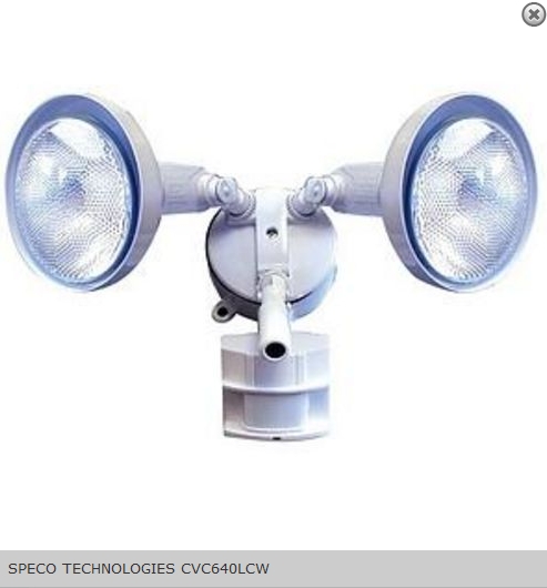

What about something like this above the door but in an IP version? I see you already have one, but this one
has a camera in it.
Or I could mount a bullet or dome right below the light? Whats one more hole in the siding right?
There won't be one more hole cause the camera would be covering it. My idea of replacing the light with a covert camera was because the light is so low and would get a lot of detail and facial ID but you don't want the bad guy knowing there is a camera there so he can't vandalize it.

I like vector's replacement floodlight cam idea but don't know of any IP versions offhand. Most I've seen just record to an SD card that you have to pull out to review if you have a break in. That Speco's a bit pricey for analog (and obviously will be tricky to integrate into your network camera system unless you're thinking of using a hybrid NVR already) but is probably good for a covert camera (I've never seen footage from one). Speco's a pretty good name. What're you using for an NVR? Make sure it'll handle motion detection for both the Dahuas and whatever you find if you decide to go the covert IP cam route.

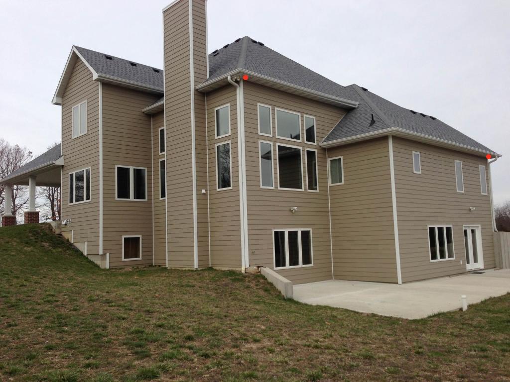

Finally got around to taking a wide shot of the back yard area. The updated pic should give you a better idea of the overall rear and side of the house. I placed two red dots where the cameras could be in a cross-view configuration. Then I guess placing one more down by the door for ID. However, the single casement window at ground level seems very vulnerable to me. Its tucked into a corner, and someone could remain in that corner for quite some time without any camera seeing what they are doing.
I guess you found the next spot for a cam outside. Either that or one inside on the wall facing the window with nice bright LEDs peeking OUT that window from the inside with a sign saying "Smile, you're on Candid Camera!" LED glare on the window will probably make it useless for catching someone looking in the window but you'd get a great shot if they came IN through the window.
