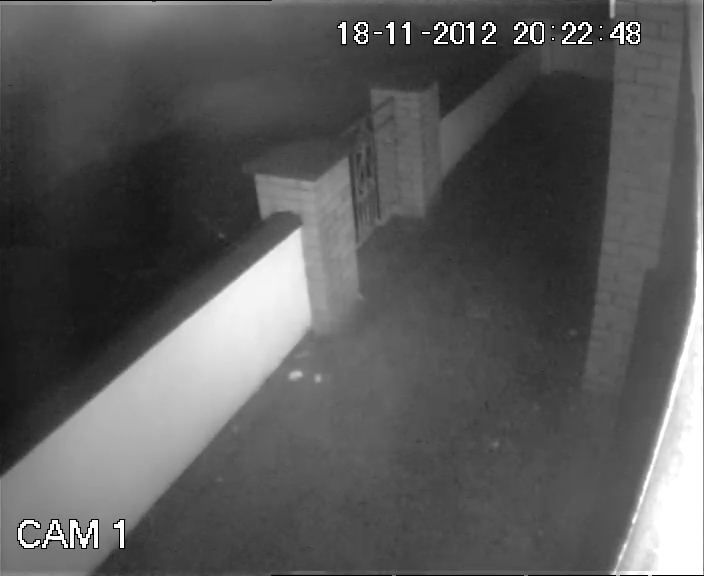

ok but how will the cameras see at night you can see from the stills mine cant see anything at night with no light

My cctv guy says no matter what i use i wont get great night time viewing with out having to install lighting hay does cameras have irs if you need to put in lighting to light the place up

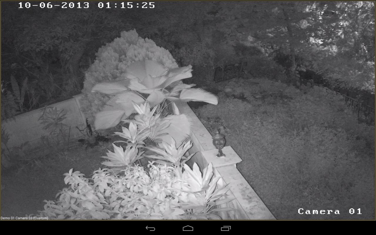

Well, he is right in a certain kind of way, if you have good lightings when your HD camera capture the events, it will be in color. If not you will only see black & white like this.
What make of camera is this?
HIK

from the video it does look like a IP camera - good results by the way
