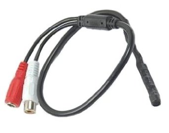

Indoors you can use a cheaper mic as it doesn't have to be weatherproof. Depending on the camera you get, you'll need an amplified mic or not. Most require an amplified mic and there's tons of them on ebay or amazon, just search for CCTV microphone. It will typically have a pigtail with a power connector for 12V and RCA style connector for audio. The camera will either have a terminal block you attach wires to or a pigtail. If it's a Dahua, it will have an RCA jack to connect, Hikvision will have just wires coming out or a terminal block depending on the model. Axis or ACTi have terminal blocks you wire into.
Here's a picture of typical amplified mic
