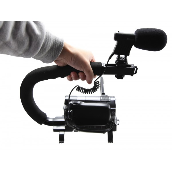

OK, now I understand, you need a good omnidirectional mic and a camcorder. Having an IP camera would not be a good idea for this.
The microphone you mentioned, the one that comes with a dead cat will not work because it's like a shotgun mic, designed to reject lateral noises and focus on a narrow area in front of the mic. Good for doing press interviews, not so much for covering a large sport field.
Mic's usually have a sound pattern in their specs, so you can see what they cover. Also look for a stereo mic as they have 2 mics inside of one to cover left and right sound. Look for one with a big foam head to reduce wind noise.
