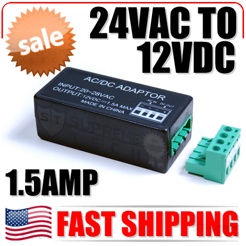

If you suffer from lower voltage i.e. voltage drop over a long run of cable, then sometimes you need to start with either a higher voltage and a good power rating. This is easier said than done as we cannot always find a reliable economic small variable power supply, so there are other practical solutions.
Typically we do this;
Start with 24Volt AC and use a drop transformer of the correct rating i.e. 12vDC with a suitable current rating at the camera end.
Then you will have a solid 12V supply at the point of delivery.
Alternatively, use 24V AV cameras since AC volts suffer far less from voltage drop than DC power.

@ NUMBNUTS - good post on those voltage converters, I'll have th check em out. Any further info?. I've been making my own but they look obviuosly "homemade" & are about 3 times the size of the ones you've shown.
