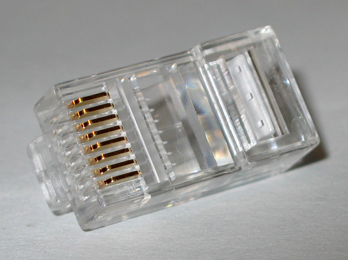

Ok, just to clarify things an RJ-45 is a connector that looks like this:
The cable you are referring to is probably eitehr CAT-5, CAT-5E or CAT-6. You can read the stamped writing on the cable to determine that.

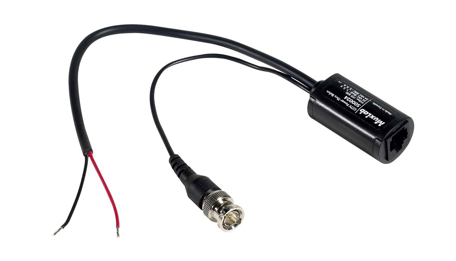

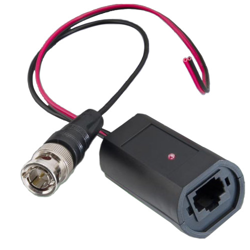

The easiest way to use CAT5/6 wire with an analog camera is thru a pair of baluns which have a lot of different styles to them. Some provide power and some do not, you absolutely need one that does provide power. In general they will look something like this:
