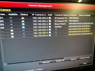

Having a lot is issues with camera's which cannot be removed.
I have only had 4 camera's but 1 of them is not is use so have removed that cable from the NVR.
I did rename all the ip's on the cameras using the software and this looks where the issue lies.
Tried a reset on the NVR and still the same.
So how can i remove these from my NVR as they showing 'no link' when go to the menu.
http://i61.tinypic.com/qybzpl.jpg
Only the bottom 3 are in use.

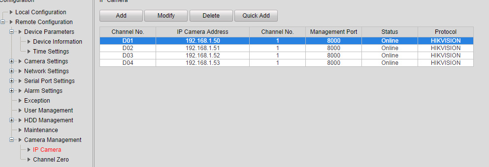

On the web interface:
Restore - Reset all the parameters, except the IP parameters and user information, to the default settings
Default - Restore all parameters to default settings.
I think the second option should do it. I am quite sure it also can be done from the device.

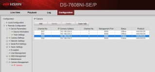

Went into web interface and the four ip address' that are an issue are there, but the modify and delete buttons are disabled/greyed out.
