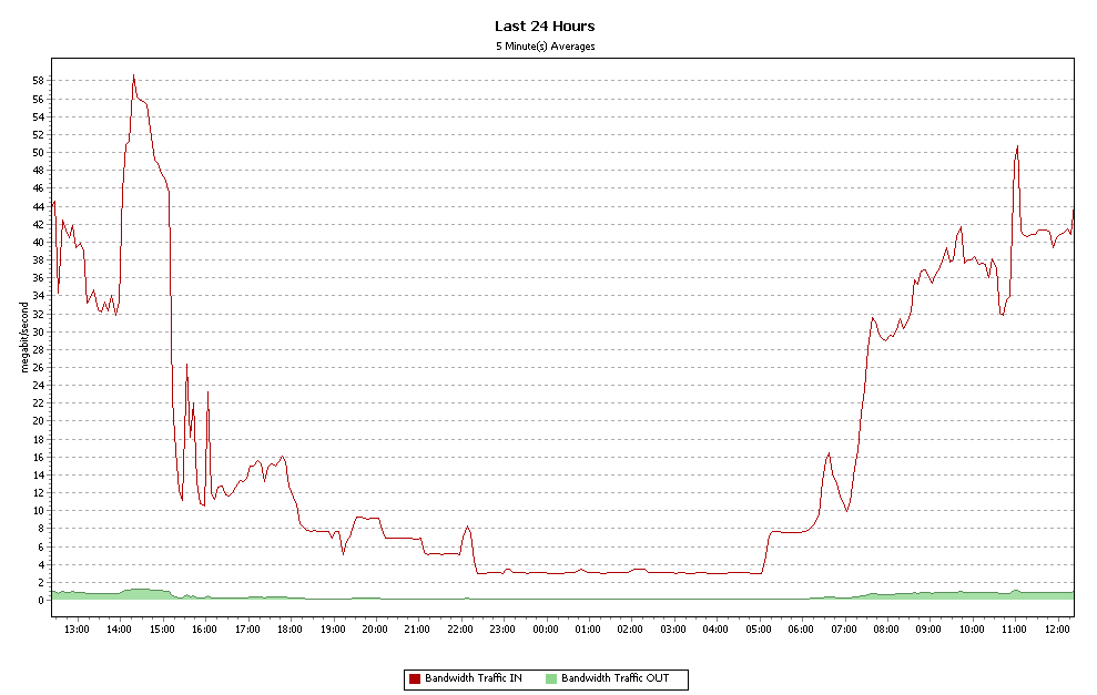

This is a graph of the bandwidth usage for one camera, for anyone interested.

Who knows. Playing back from the archive doesn't work properly, it will work a for bit then it will just display errors. It might be the amount of data it is storing that is the problem, i only have one camera recording at the moment and it is using over 150GB per day.
150 gig a day?
i belive there are options to change the recording quality within the framerate, however ill be investigating properly 2mrw as im getting a demo camera and kit
150 gig a day?
That was at high quality, i now use half resolution and motion detection. You really need megapixel lenses for these cameras to use the full resolution.
