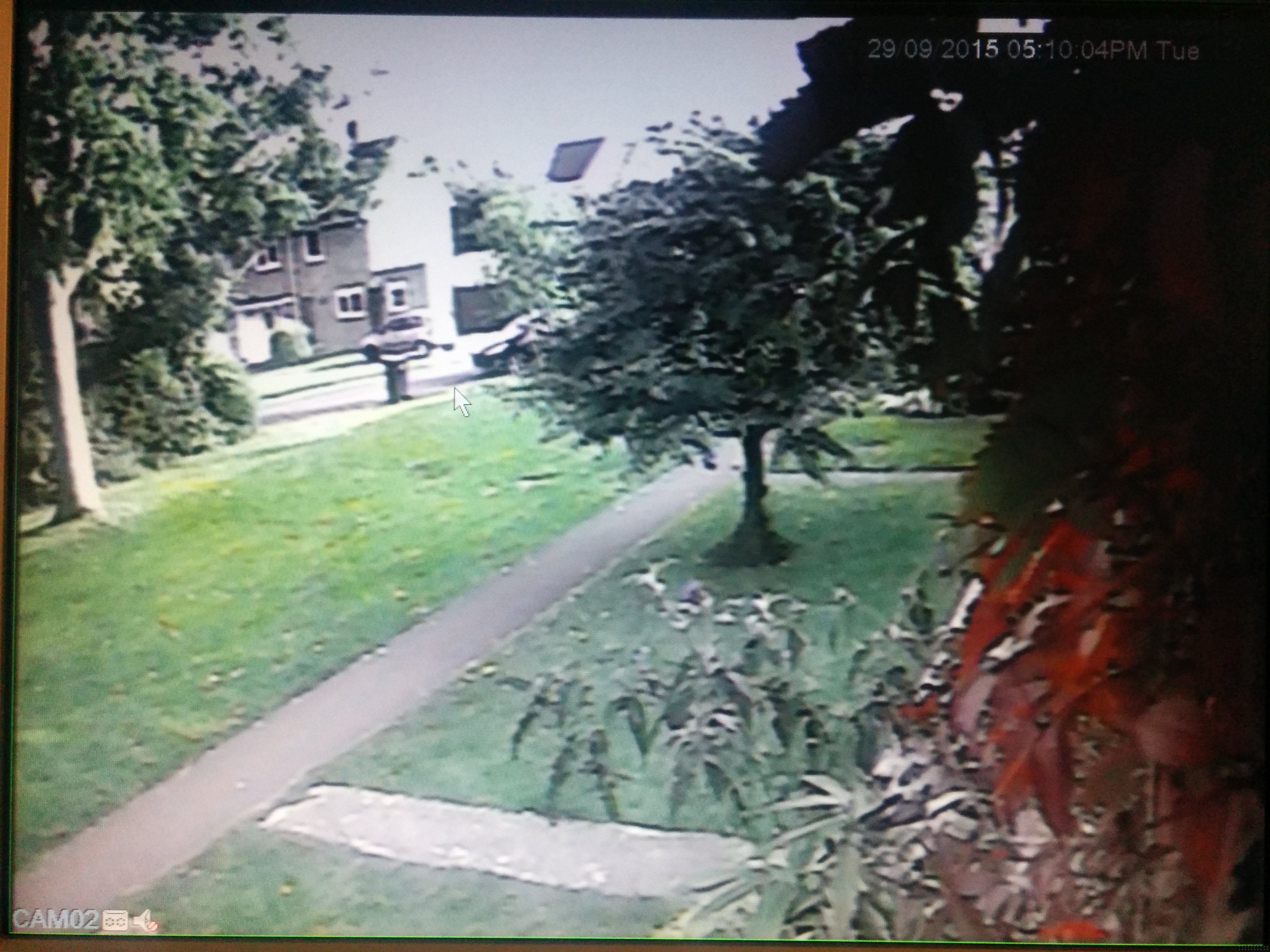

I have installed a SANNCE CCTV system (link here http://www.amazon.co.uk/gp/product/B00K4WP5LI?psc=1&redirect=true&ref_=oh_aui_search_detailpage) however the quality is very low, as seen below

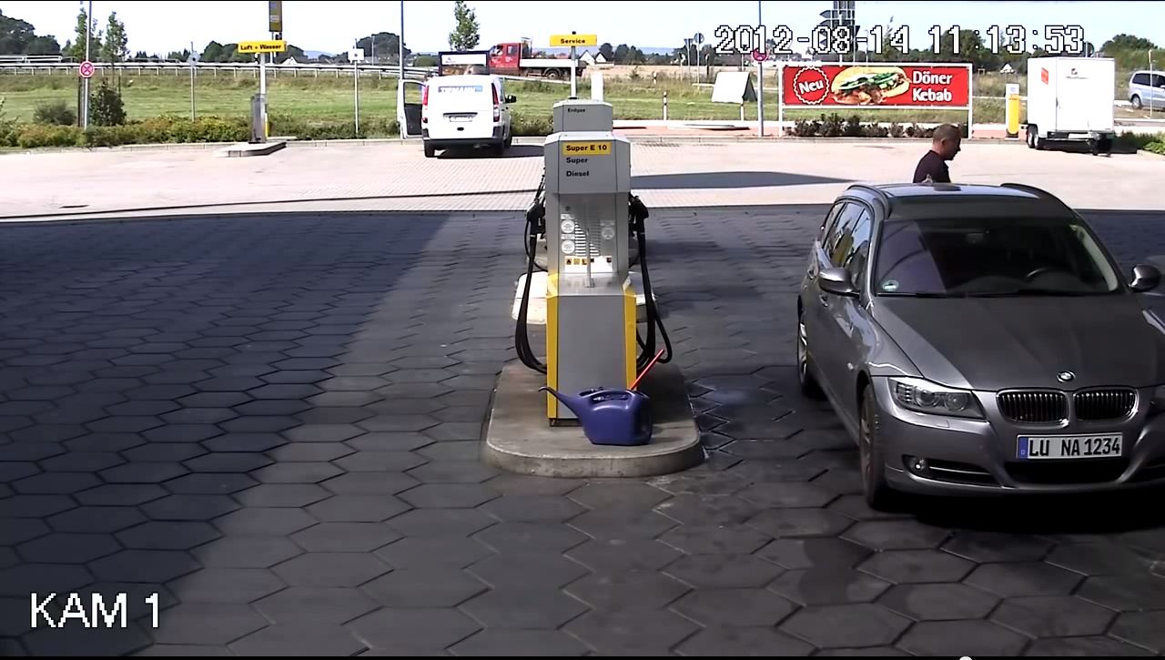

I had assumed it would be low quality, however this is particularly bad. I also found supposedly example footage (from an independent reviewer) which looks like the following
Is this a problem with the cameras, the DVR, or both? What would be the most cost effective way of improving the image quality?
Hi your system from Amazon is analog .... It should have a better image than your photo but not by much
Your second photo is not your system so your not going to get images like that

The second photo was taken from here - http://topcctvcameras.co.uk/sannce-cctv-review/
It looks like the same (or very similar) system for a similar price, so maybe the image has been incorrectly sourced?

That image is 100 percent fake. The most cost effective way to deal with it is to return it. Look at ip camera systems...
Get at minimum 720p cameras....1080p would be even better.

First not a uk image in fact none are on that website
Then there is the problem of website being new so don't take any notice of reviews
Then look at website again .... NO CONTACT INFO
QUICK UK company check and they don't exist ..... Big mistake if you buy from them
